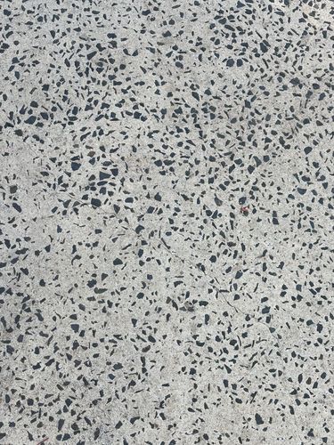

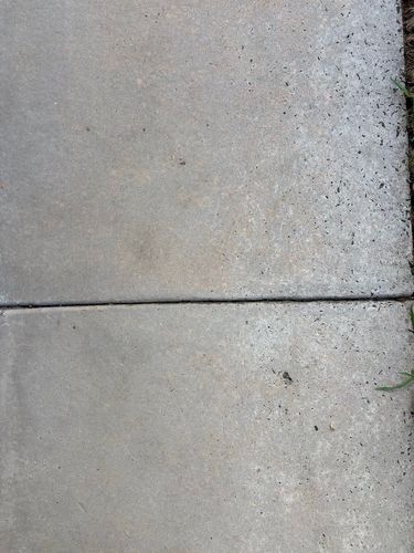

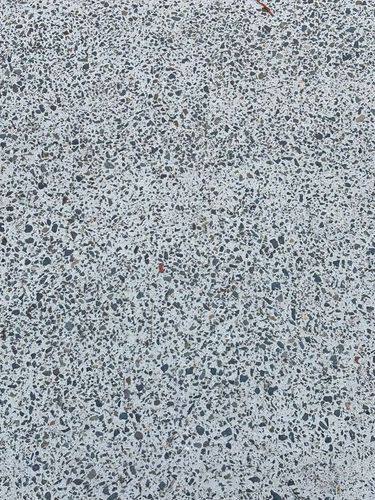

I have an existing concrete driveway that I am looking to seal using a sealer. I have already cleaned the surface using pressure washer and have let it dry.
Just when I was about to purchase a sealer, I came across normal sealers and 'exposed aggregate' sealers. I am not very sure about the type of concrete finish I have.
I am attaching some pictures taken at different locations of the concrete driveway. It looks to be a mix of plain vs aggregate but can someone from the community help identify the type of finish and help with choosing the correct sealer.
Thanks a lot for the advice.

It looks like like your driveway has a mixed finish of plain concrete and exposed aggregate. To ensure the sealer works effectively across all areas, I suggest using a product like the Crommelin 10L Clear DiamondCoat Exposed Aggregate and Polished Concrete Sealer. Sealers designed for exposed aggregate are typically versatile and capable of adhering to both porous concrete surfaces and exposed aggregate, providing a uniform and durable finish. This product should meet your needs and ensure consistent protection and aesthetic appeal across your driveway.
