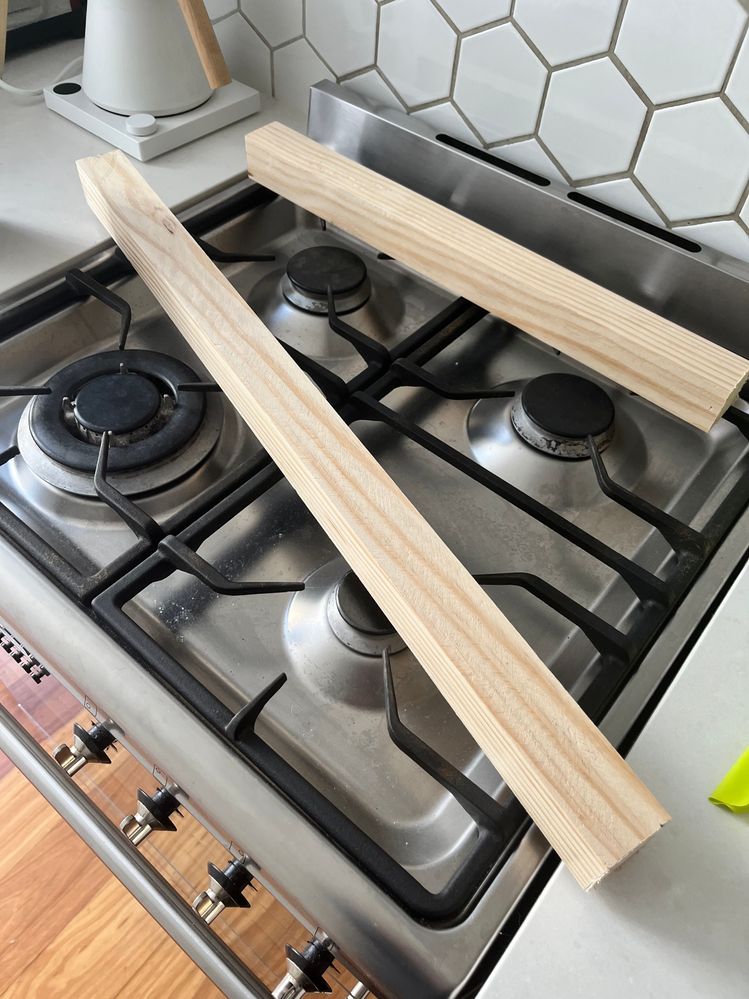

How to seal a piece of wood before painting?
Hi there, I am replacing a piece of wood outside which will need to be sealed prior to painting - see pic. It's a relatively small piece.
Looking for your
just the one piece needs sealingsuggestions on a suitable product.
Cheers,
DIY Duncan

Re: Sealing a piece of wood before painting
Hi @DIY_Duncan,
That looks suspiciously like untreated Pine, which isn't suitable for external use. Sure, you can seal or paint it, but it's still going to have a very limited lifespan once moisture eventually finds its way in. At a minimum you should be starting with H3-treated Pine, which you'll also need to paint.
If you wanted to proceed with the untreated Pine, you'd use either exterior varnish or paint to seal it. I am not aware of any sealer designed to be used before painting. There are timber treatments, but those are designed as supplementary coatings to seal cut ends on already treated timber.
