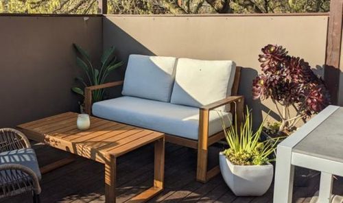

Hi!
I have an outdoor, 2 seater daybed that is made of eucalyptus wood and finished with a natural oil seal (presumably linseed).
It is brand new. I want to seal it with a Polyurethane based finish as this particular piece, whilst quite nice to look at, is very susceptible to water damage.
What type of PU sealant (or otherwise) should I use. I was erring towards ‘Cabot’s Cabothane’ but couldn’t find any information about its water permeability.
I had also been recommended Cabot’s Clear Satin Exterior Finish but it says it is not suitable for outdoor furniture.
Thanks!

Are you able to share a photo of your daybed? I'm sure we'd all be interested to see it.

The seat is brand new but as I understand it the oil finish it comes with is prone to bleeding and not resisting water well (moulds easily etc). A matter of aesthetics over functionality.
In this case, could I use something like the Sikkens Citol to coat the furniture and prevent further damage.
Is there any coating I can use that doesn’t require me to sand back the wood?
