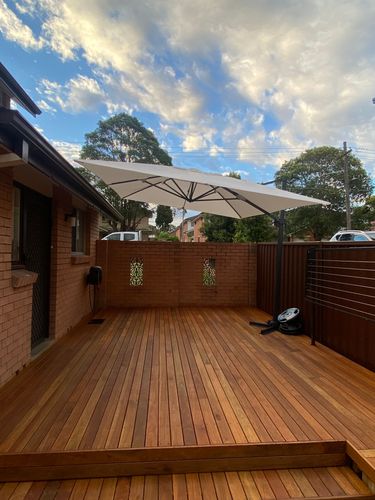

Around January this year I completed a full backyard renovation and laid down a beautiful spotted gum deck, finished with Cabot’s natural decking oil (two coats on underneath, sides, ends and about 3-4 coats on top).
Unfortunately, two days after the last application of oil, we had over a month of torrential rain.
You can see from the photos, the deck completely lost it’s original colour and there is now some black spotting and green mould forming.
It’s now coming up to summer and I’d like to bring the deck back to how it was. Do I have to sand back the entire deck? Do I just use mould remover?
I’ve attached pics of it before and now.
Help - I need your advice!

You might like to look at this helpful guide on How to restore a deck. I'd suggest you pick up some Cabot's Deck Clean and a stiff bristle broom. Once you've given the deck a couple of goes over, you'll be able to access what the next steps will be. If those stains have penetrated so deep that cleaning can't remove them, then you might be looking at having to sand the timber back. Hopefully, it's just a matter of a thorough clean and re-oil.
Once you're done with the cleaning and have uploaded some new images, we'll be able to advise you on what the options are.
