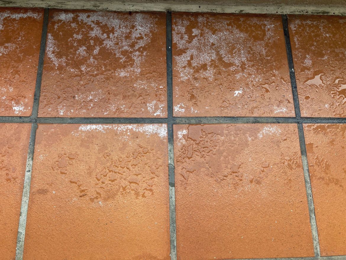

Oh dear.
I was so pleased after sealing the balcony tiles with Crommelin Stone Sealer and all was fine for a week until last night when it rained.
I can't scratch the white patches off with my fingernails as it's rock solid.
I'm at a loss what to do.
The tiles were stripped with Crommelin sealer remover. washed with a pressure hose then re-sealed.
Help?

I'm really sorry to hear about the trouble you're having with your sealer, especially after the effort you put in. It must be so frustrating to see those white patches appear after everything seemed to be going well.
I’ve spoken with the Crommelin technical team, and there are a few possible reasons why this might have happened. The first could be related to the tiles' porosity. Did you perform a porosity test? If water is absorbed and the surface darkens, it's open to sealing. However, if water beads on the surface without being absorbed, the tiles may have a non-permeable coating or glaze, making them unsuitable for sealing.
Another possibility could be the amount of product used. If too much sealer is applied, you might see a milky film that can turn white when exposed to moisture.
It could also be moisture coming from beneath the tiles or entering at the edges, getting trapped under the sealer and causing the white patches.
At this stage, I’d recommend allowing the tiles to dry out fully and see if the issue resolves itself. If it doesn’t, Crommelin's 1L DiamondCoat Clean N Prep can help remove the sealer from the affected areas. From there, we can perform a porosity test to check the surface and then look at whether moisture is getting into the tiles before reapplying the sealer sparingly.
Please don’t hesitate to reach out if you have any questions or need further help.
Hi. Left the tiles for a week but no real change.
Diluted Sealer Remover cleaned up most but left staining. Diluted and spread the patches really.
I'm thinking I put extra sealer on the patchy tiles due to the fact the front tiles catch the rain and need more protection.
Hence, too thick and not properly cured perhaps before it rained.
I'll go slowly and use thin sealer coats well-spaced next time.
So . . . should I use Crommelin Sealer Remover to strip tiles bare as I did before sealing or Clean 'n' Prep as suggested above?
I was advised by the Crommelin's technical team to use the Clean N Prep to remove the sealer in those areas, @477bus. You could likely use the sealer remover, but their advice was to use the clean n prep when I walked them through the issue.
Progress check . . . I tried the Clean n Prep today and now most of the front tiles are cloudy instead of half a dozen.
The CnP can says refer to the DiamondCoat Technical Sheet which I did.
It states that water-based sealers need to be removed and re-applied when cloudy.
The CnP seems to be a weak sealer remover so I'll use that up first and if no good I'll use proper sealer remover again, as I know that does work.
I'll let you know.
