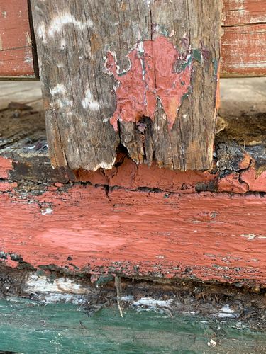

BTW how much rot is showing and how close to the ground is the rot? I have seen some adds for timbermate products that have been unbelievably good. (It converts rotted timber to something solid again) So that could be worth looking at.

Thanks for sharing your question about your veranda posts. It's great that you've received excellent advice from @Dave-1. I'm in agreement with his recommendation, using the 100 x 100 post is an ideal replacement. The ends can simply be trimmed down in order to fit into its old position.
Would it be possible for you to post a few photos of your veranda? It will give our members a chance to assess the posts damage. Plus, it will show us how the posts are installed on your veranda.

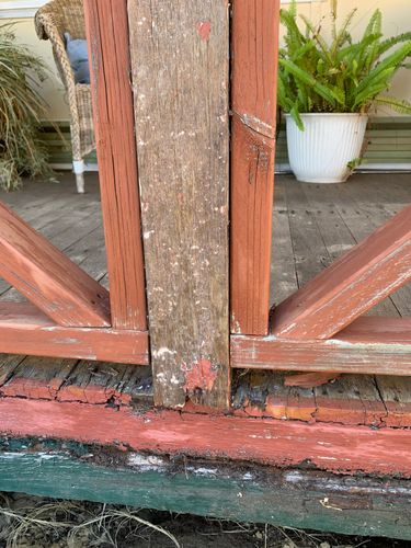

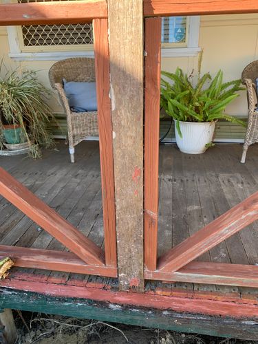

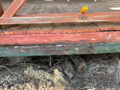

Just saw your pics and that is going to be an interesting job. Possibly a large job.
Id be tempted to get down under the deck and see the state of underneath. That rot looks a little concerning.
When you replace/remove the posts make sure you support the roof with the support posts. Gorilla 1.98-3.35m Galvanised Formwork Prop #2 Tho I think you may need to do one at a a time as your work along replacing the posts and bases (I am used to seeing piers under a post so its messing with me a little )

Hi @Neen
Thanks for sharing those photos of your veranda. Your deck frame seems to be deteriorating as well. I suggest engaging the services of a registered builder and having them assess if the frame is still in good condition. It would be a shame to update all those posts only to find out that the deck frame is compromised.
However, if your deck is still in good condition and the damage is only superficial, I suggest repairing it and painting the surface to protect it from the weather.

the only damage caused by wood rot is the face boards and 1 stump which will be replaced.
im also replacing the floor board to beaten up the appearance.
