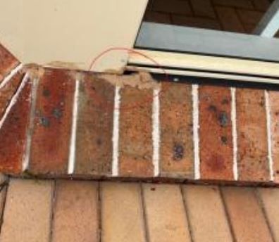

I am purchasing a property with the rubber flashing on one or two of the windows has been damaged. I've been endlessly browsing but I can't seem to find the correct item to purchase.
Additionally, how would I go about installing some new flashing in the instance below?

Is the window leaking as a priority or a cosmetic fix would you say.
Both are important so we will go for gold.
That rubber flashing is some times unique to the brand of windows is the first problem. The second problem is how to removing and replacing the damaged rubber onto the frame some are threaded on from one end at the time of construction. Some may be designed to come away.
Dunlop rubber carries a range of rubber strip profiles for all manner of general purpose applications and vehicle trims
Bunnings has some D and U shaped rubber in there door seal range that may lend itself to fit between the window and brick.
But I think a universal repair could be terracitta color silicon along the cream metal edge to match the brick work. An I know bunnings stocks square foam rubber that can be poked into the gap between the window and brick and will stop a water leak but only 7 out 10 for looks.
Or a clear out door silicon can be used once that brown stuff peeled off it will caulk along there on both the wall cream panel and at the brick work and old rubber seal is sealed over. Using masking tape to run a bead of silicon is the best way.
This fix comes down to what level of repairs you wish for.
We will try and help.

Mmmmm There is a temp way that comes to mind and then a proper way......
Temp way would be to use selleys 290ml clear storm waterproof gutter and roof sealant (I actually stole the product from @Erics original post )
How to protect timber window frames This would be the easiest, not sure how long it would last (As in years)
Proper way would be to remove the window and redo the flashing (That sounds extreme tho)... Can you see any flashing under the window frame? Mmmm I would only do this in a worst case scenerio tho. The Waterproof really should work.

It's great that you've received excellent advice from @Jewelleryrescue and @Dave-1. They've pretty much covered the bases on what you can do to repair the rubber flashing. Looking at the picture you posted, I don't see any major damage to the area.
However, if you are worried about water ingress, I suggest sealing the edge of the window with Selleys 290ml clear storm waterproof gutter and roof sealant as Dave-1 mentioned.
At this point in time, I recommend a wait and see strategy. Keep an eye for leaks near the window frames or where it might possibly pool if leaks were to occur.
If the current seals hold it's possible that it might still be good for a few more seasons.

Thank you EricL - will definitely try running a bead of the sealant along the bring once I clear it out.
I appreciate all the responses everyone - it was very reassuring!
