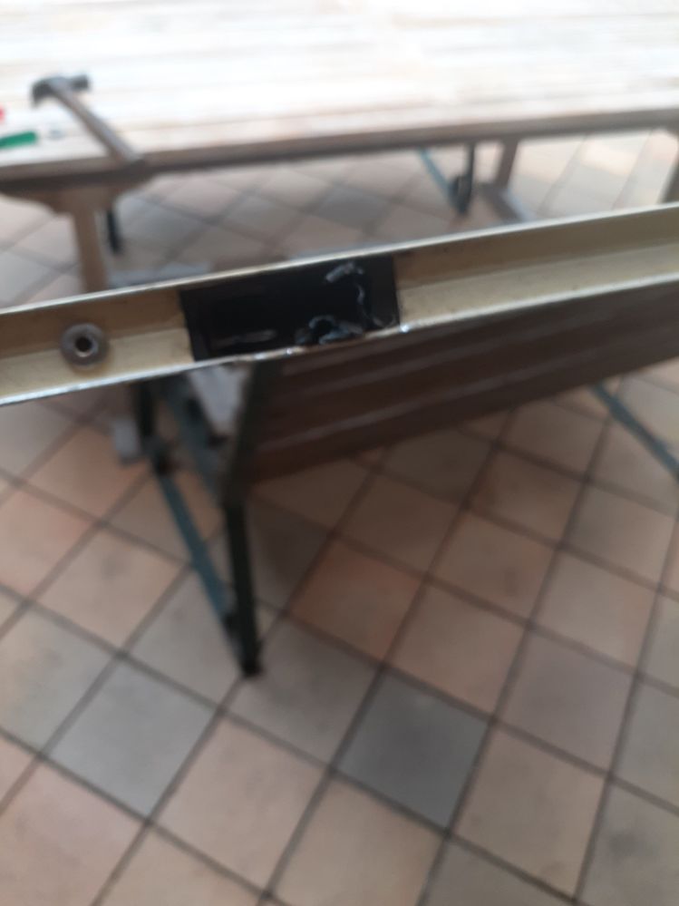

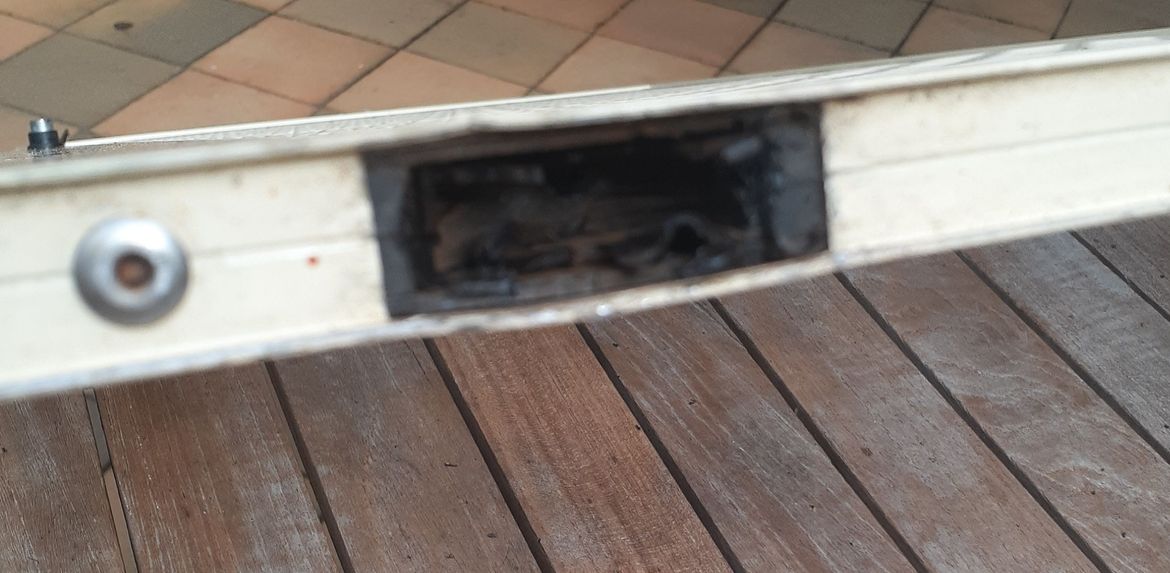

I've read similar topics that say brute force may be required to remove the plastic housing prior to inserting the new assembly.  I've tried a fat head screw driver, hammer, needle nose pliers.  I can tilt the housing but can't get it out.  Bits of it are starting to break off.

That photo is a little blurry to see  greater detail or I might have eaten to many brandy snaps.
But they should be screwed in wheels?
So take them  out  and with you to  bunnings  to select from a range of compatable wheel sets Some new  wheel adjustment maybe  requirred this is usually a simple screw adjustment.

"So take them out of starters."   That's the problem, I can't get them out.  I've completely butchered one trying to get it out.  It would be so simple if they were just screwed in20231227_170332.jpg

I'd imagine those inserts have a dogtooth that locks them in place. To remove them would require their destruction. I'd continue as you have been and try to break them apart. You might wish to place some drilled holes in them to compromise the plastic and allow it to be broken apart more easily.
