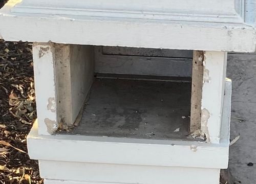

Hi, I need to replace my letter box I got home from work today and found the front of my letter box had been ripped off the measurements are roughly W 260mm x H 165mm x  L 355mm just need some advice if there is a product that can fit in the hole.

Let me tag @Noyade to make them aware of your inquiry. There are a few letter box fronts that might work with the space of your concrete letter box. The Sandleford 203 - 500mm Brick In Letterbox Sleeve is the default body of most of the Sandleford brick in letter box sets. The fronts although bigger in the front are actually clipped onto the letterbox sleeve. An example is the Sandleford Black Chalice Brick Insert Letterbox. Please remember to double check the measurements of the space to make sure it fits.

In the meantime, just a thought using square tube steel to fit the rebated areas with a steel plate front.

Hey @Noyade, thanks so much for replying.  I couldn't work out how to log back in so its taken a week to see this reply.  I love the idea and look of what you have shared. I didn't build the letterbox, it came all assembled but when the thief ripped out the brass front it has broken away some concrete.  I'll check out the off the shelf options but I think I'm leaning to a bespoke option (if possible) so let me get back to you shortly.  Thanks again.

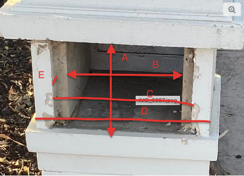

Screen Shot 2025-05-04 at 5.33.21 pm.pngHi @Noyade I have measured and remeasured and it appears to me that none of the off the shelf option will work without a fair bit of tweaking (something I don't have the skillset to do unfortunately).
If you are still willing to help I'd love a bespoke one from your skilful hands.  I have included the specs, they are pretty close to the mm so you might want to shave a little off for adhesive(??).
A 162
B 191
C 227
D 288
E 28 (rebate)
