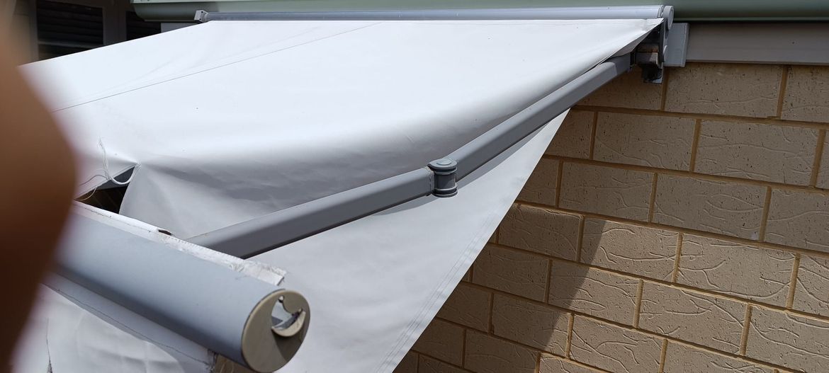

My awning has torn after some winds and I'm looking to change the material. Does Bunnings sell material or awnings that I can cut to size ? If not, know any other ways to change the material ?
It's dimensions whilst on are:
Awning size: 184(6ft) wide x 140cm(4ft, 7 inches) long.
Thanks !

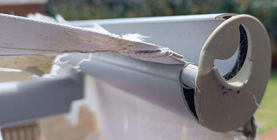

Thanks for the link to the awning cloths. The only thing is that i need cloth that has the 2 loop holes at either end to slide the long thin plastic bit which holds it inside the cylindrical ends. Do any of your cloths have this loop hole bit? (see photo)

Unfortunately, no, they don't. You might need to hem the shadecloth on a sewing machine, creating a pocket so you can insert the rod they've used on your current awning.
