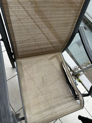

Can you please tell us about your chair? Do you know the manufacturer and how old it is? Do you know what the material covering is? A little more information might assist members to provide more helpful advice.

Hello @copland92
Welcome to the Bunnings Workshop community. It's wonderful to have you join us and thanks for sharing your question about your outdoor chair.
I suggest having a quick look at this discussion - How to repair torn fabric on balcony chair? by @arnab. In the discussion I suggested using Coolaroo 3.66m Graphite 90% UV Heavy-Duty People Cover Shade Cloth - Per Metre as a possible replacement for the chair fabric.
Generally speaking, the chair must be disassembled, and the plastic end plugs removed. This will allow you access to the plastic insert that is holding the fabric in place. Once you pull the plastic insert out you should be able to remove the damaged fabric from the chair.
Observe carefully how the ends of the fabric were sown or folded as you'll need to copy it in order for you to re-assemble the chair.

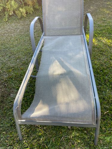

will this fabric be the right width for this garden chair
Re: How to repair outdoor chair?
Hi @garden-chair,
The Coolaroo 3.66m Graphite 90% UV Heavy Duty People Cover Shade Cloth that my colleague @EricL has linked to above is 3.66m wide and comes on a big roll that is cut and sold by the metre.
Assuming the chair in your photo is not abnormally long, 3.66m should cover the full length of the chair, you will just need to measure the width of the existing fabric and have it cut to that length.
