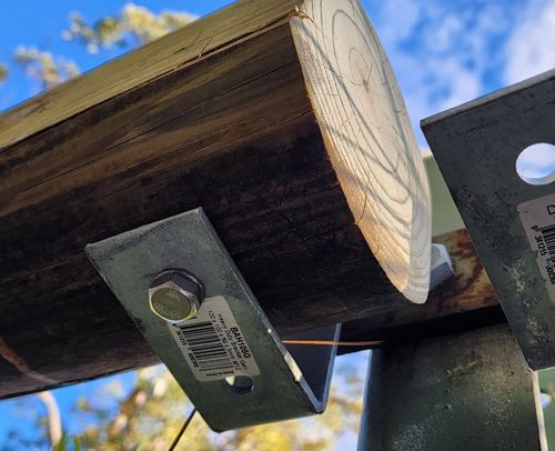

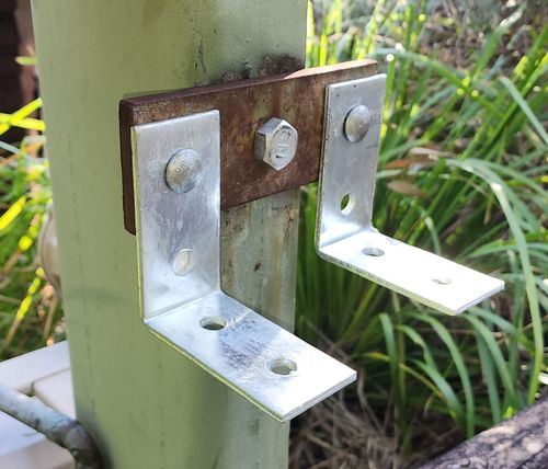

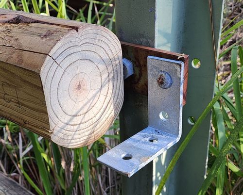

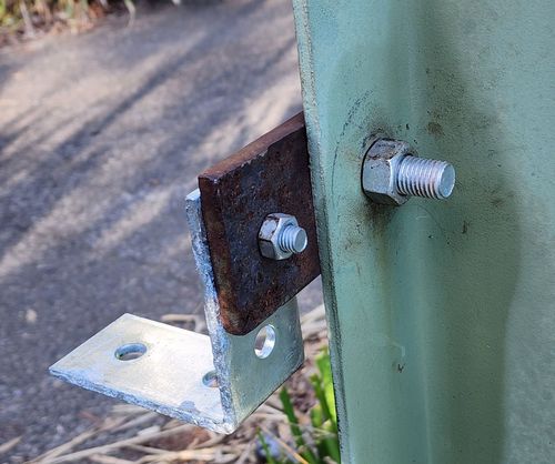

OK. It's almost done. I reused the existing plates, attached brackets to them, and screwed the sleepers from below. I reused most of the sleepers, and replaced 4 of them.
Thanks for everyone's help!

Thanks for the update and for sharing some new photos.
The solution you've come up with looks great, and I'm glad you were able to reuse the old brackets and the majority of the sleepers.
This will surely last you for years to come and if you need to change anything, you know exactly how to do it.
