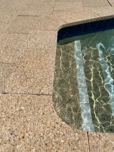

I have an old concrete pool with exposed agg bullnose pavers that have come loose.

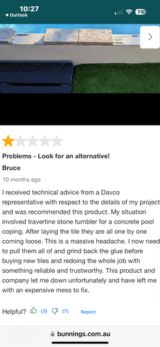

I’ve just seen this review on the Davco product!  Now I’m not so sure again!

The  1 star reporter Bruce may not  have not have cleaned off the old loose morter and or glue off or  some other condition davco didnt take into account.    The new glue stuck to  old glue remaining but stopped sticking when  the sames old glue failed once more coming away from the pave underside and pool area.  . I totally feel for Bruce I do because we all being there and done that,  Thats  why you are her to get the best advise to try not suffer Bruces fate so thank you for allowing the Workshop to address your concerns.
Can  we please see one of you under tiles lifted and place next to where it was situated and do a photo in good light to try give the best advice thank you in advance as you wish does the   old glue crumble easy?  Can you get back to original clean  tile.?
1) The single most important thing to do is  lifting the tile and removing as much of the old adhesive that was attached to it. Rub it with you gloved hand if more  comes away keep  cleaning.
2) Two looking at Bruces photo as it is small it looks  like the glue had a very  good surface contact area better that a lot of Pro tiles achieve,  But I am looking at his  tlles and they seamed alms pre sealed  (Travertine is highly porous and really needs sealing)  which may resist dirt mold stains and in that way the new tile adhesive)   Your  pavers are cement based pebblecreat and wont need sealing all the way through.
3) I am pretty sure most of the reviews  where good?   Daveco usualy puts out a pretty robust product.
4) It is ok to loose faith in a product I sure shop around for the best cost effective  long term solution.  Mabye  review  plan B product as a back up idea.
