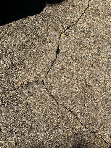

How to repair cracks in Pebblecrete?
brendonh
Was wondering what adhesive to fill cracks? Am going to pat down new pebbles into adhesive. Any suggestions?
Re: Cracks
Hello @brendonh
Welcome to the Bunnings Workshop community. It's sensational to have you join us, and thanks for sharing your question about your pebblecrete driveway.
Technically the cracks can be filled with Gripset Betta 1L Concrete Crack Filler, it will seal the crack and prevent water from flowing into it. But it will not be the same colour as your pebblecrete and you can't put pebbles into the sealant.
If you are after a surface repair to cover the cracks, I propose engaging the services of a resurfacing specialist who has experience with pebblecrete. I'm sorry but Bunnings does not currently have a pebblecrete crack repair filler that will produce the same surface finish.
