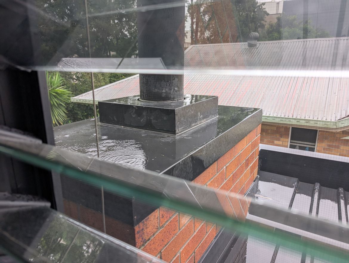

Also, the rain seems to pool on top of the rectangular base instead of sliding down a slope
It is very flat with no real gradient. In fact, there may be even a tiny divit in the base leading to pooling
Any suggestions how to fix that so that the rain moves down the rectangular base rather than have rain accumulate on it.

Water pooling in the rectangular base

I think it is best to just manage the potential entry points for water and allow the water to sit and dry naturally.
Unfortunately, the only way I could see to fix that issue is to remove the metal, create the fall on the surface beneath and then reinstall it. This would obviously be quite an undertaking.
If the water pooling is not causing any issues, I don't see the benefit outweighing the cost to have this done.

Are there any plastic products that could potentially create a small incline that will allow the water to flow down?

Unfortunately, no, at least not that I am aware of.
Perhaps @Dave-1 or @Noyade may have seen something that could work?
It might be a silly question, but is there any way to access the underside of the metal flashing?
If there was, you might be able to install something to prop up the dip that little bit.
Let me know what you think.

I can see stain marks inside the house from rain leakage which appears that have been there fo rmany years. Hence the extra precaustions that I am taking.
I can not access the underside of the metal flashing. It all appears well sealed

With the water pooling, Like @JacobZ has mentioned id be tempted to make sure you seal the chimeny with the flashing and the base of the square unit and then just let it dry naturally. Trying to get a bit of a rise so the water would drain will be a hard effort for sure and I dont think you will get much of a return on it.
