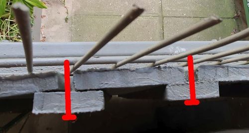

Please advice wooden fence repair,nails have come out with gaps,how and what sort of nails,tools .Thanks

The nail heads look to be painted over which is making the task more difficult. If you have a drill, use a small 2mm drill bit and make holes tightly around the outline of the nail heads which should release the pressure. Then use your hammer to tap around them firmly which should hope let you access the heads to pull the nails out.
The boards appear to be weathered bent so if @JacobZ suggestion to drive nails in on an angle doesn’t work you might need to replace the nail holes with flat head galvanised screws to pull them back in and hold firmly.

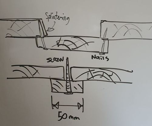

Looking closer - is it a combination of screws and nail-gun nails - with limited penetration and very narrow areas to attach?
And some of those areas have splintered.
Plus it looks looks to be most of the top fence.
I had a similar issue with a side fence and gate. Nails had been used and all the areas of nailing had splintered.
I took it all down.
I reused palings which were in an acceptable condition, purchased some more and then ripped in half some of the unacceptable palings - down to 50 mm.
This time they were screwed - not nailed - but with only a 15 mm gap. I covered this gap with the ripped palings and long screws down the centre.
That was 15 years ago.
The security prongs are optional.
Probably not the way you want to go - but thought I'd just share a similar experience.
