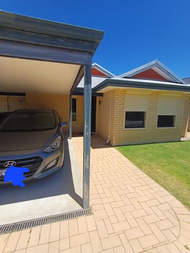

So our steel carport posts need some work.
The existing paint is chalky & faded & missing in places on this post, the other 5 posts mostly just faded & chalky.
One post has something sticky in places, no idea what but washed with sugar soap & still a little sticky.
So what is the best way to go.
No idea what sort of paint was used, guessing it's as old as the house, 22 yo.

I'm not seeing any surface rust there, so is it just the topcoat that is peeling, and the undercoat is still in place? If the undercoat is sound, you can sand back the top coat to remove any loose, deteriorated and chalky paint and remove any sheen from it with 180-grit sandpaper. You should then thoroughly wipe down the dusty surfaces. Once clean, apply Dulux Metalshield Epoxy Enamel. This product doesn't require an undercoat over the existing undercoat or pre-painted surface. If that is bare steel, you'll need to apply the Metalshield All Purpose Primer.
