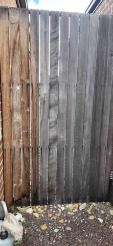

How to refresh a fence gate?
Where do I start with this fence door?

Re: fence door refresh
Thank you. It does have existing post in the ground on both sides. I should have been more specific. I am trying to refresh this gate/door as it looks a little weathered. What would I require. I have looked at fence paint but prefer brushing than spraying as it's only a small surface.
Hi @eloise89
options
First you have to decide what you want they all will refresh you gate in different ways
1 Wood Stain . Like a clothes dye You can stain the fence different like colours you can see the wood underneath. Fence paint.is like half stain and a paint And is alot cheaper than full paint.
2 Paint Paint the fence in a solid color you cant see the timber underneath and is more expensive but lasts longer but harder to paint a rough fence.
Hi @eloise89,
Thank you for your question.
There is no issue with using a paint brush or roller for this job.
Any exterior paint such as Dulux Weathershield, or fence paint such as Walpamur Fence Finish, will be a good option.
You'll want to give the palings a good clean with soapy water and a scrubbing brush before painting. Ideally, you would give them a once-over with some sandpaper, but it is not 100% necessary as long as the timber is well-cleaned.
