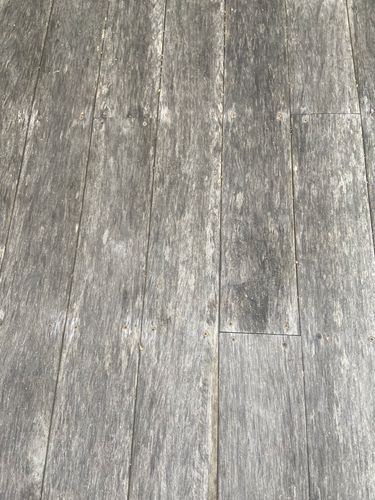

I’ve attached a photo. While the decking is pretty weathered when I lift it it’s still in good nick. The thing is it now stays at this width so doesn’t shrink. It’s really nice timber so would like to reuse!

They are very close together @Coaster. They must have been originally installed with a very small gap to swell like this and not leave any gap at all.
I'm in two minds here. Having no gap like this will lead to a shortened lifespan as water can not drain freely. However, lifting them and adding a gap would be an incredible amount of work, but ultimately, that will be the best course of action.
You could sand them back as is (they definitely need to be sanded to remove the greying and restore their finish) and ensure you oil frequently, at least once a year. If you keep the oil up to them that will help extend their lifespan, but I'm unsure how long that will be without gaps.
