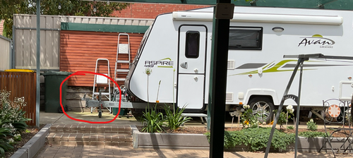

I am considering building a garage over a space that used to house a carport.  One wall of the garage would sit on top of a timber sleeper retaining wall replacing the fence that is currently there.  The frame of the garage would be attached to the existing concrete slab. I have circled a sample of the retaining wall in the photo below.  It runs the entire length of the slab and is about 1 metre high.
My problem is that I would like the garage to be watertight, but sometimes during heavy rain, water leaks through timber sleeper retaining wall and runs over the slab.  I have been racking my mind on how to prevent this without excavating on the other side of the retaining wall as that is an established garden bed on common property.

In order to stop water from flowing out of your retaining wall the soil must be dug out and the retaining wall sealed from the other side. But if this is not possible your idea of cutting a channel in the slab would be the only viable solution. Putting anything in front of the retaining wall is not going to be practical as the entire retaining wall will need to be covered up.
Perhaps when you build your garage you could create a sort of masonry wall that is waterproof on the other side, but the issue will be where the water will flow out to.

Just to clarify for those who have been helping - I was not planning on building any load-bearing structure on top of the retaining wall - the steel posts would be fixed to the concrete slab on my side, and the wall of the garage would just "hang" over the top of the retaining wall via a side-wall girt.  I would use a channel of some sort to keep water out from between the top of the retaining wall and the bottom of the steel sheet garage wall.
My thinking at the moment it to not touch the retaining wall, and instead build a dummy wall in front of it with a channel in between to deal with the water.  I hope to speak to a builder to get an idea of the practicalities of this.
