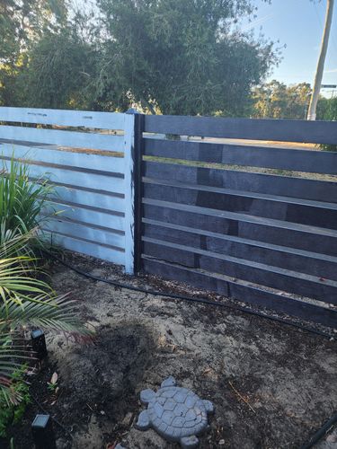

Hi, I am trying to finish off painting my fence. I no longer have me helper who used the spray gun for the outside & I am not confident using it. What is the best paint brush or roller to use with water based. My first attempt I watered down the paint too much.

Hi @Tracylee,
Do you still have the spray gun? If so, here's a helpful step-by-step guide: How to spray paint a fence. Sprayguns take a bit to get used to, but they are the most effective way to paint a fence.
If you do want to paint with a roller or brush, I'd suggest a mini-roller for painting in between the slats on their edges and then a larger roller for their front faces. For brushes, you could go with this convenient fence brush kit.
Typically, you'd only water down a paint when spraying it through a gun. If you're applying with a brush or roller then you'd use it as is out of the can.
