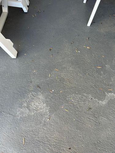

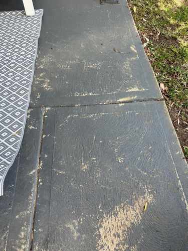

Re: self level outdoor slab
It’s a bit hard to show the significance of the uneven parts due to furniture being on it but this gives you an idea. Thanks Mitchell
Is it the brushed concrete textured finish you are referring to @Jacqueline23?
No, but that will need a finish as well. There’s up to more than centimetre difference in some places, water pools right where the outdoor kitchen will go etc
