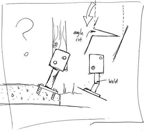

Hello, I need to install some screening posts, but the concrete slab is not level on the edges. The Pyrda Post bolt down anchor will not be level. Is there an issue if I add packers or washers to level it? Or can I just bolt it anyway and just level the posts?
Thanks

I could be interpreting your problem wrong - but if it's like this - I personally would cut a sliver of the tube section out with an angle grinder and bend until vertical - and weld it.
I'm sure better suggestions will follow, but I don't like the idea of packing with washers, etc.
Cheers!

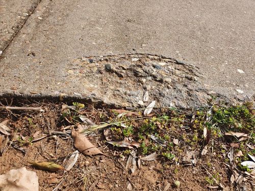

You'd likely be better off with Lanko 5kg 136 Rapid Patching Mortar as it is designed for repairing concrete. The Lanko 20kg 702 Durabed Structural Grout is more so for creating structural beds.
Noyade
Home Improvement Guru
Re: How to level concrete for posts
Wow!
Many thanks Mitchell. I'll definitely give it a go. :smile:
I'm sure you're more than aware, but you'll need to re-create that edge with formwork @Noyade. Just dig the soil away and stake a piece of Claymark 89 x 19mm x 1.2m Standard Grade Dressed Pine Sheet (or something flat) against the side of the slab. That will hold the cement mixture in place until it cures.
