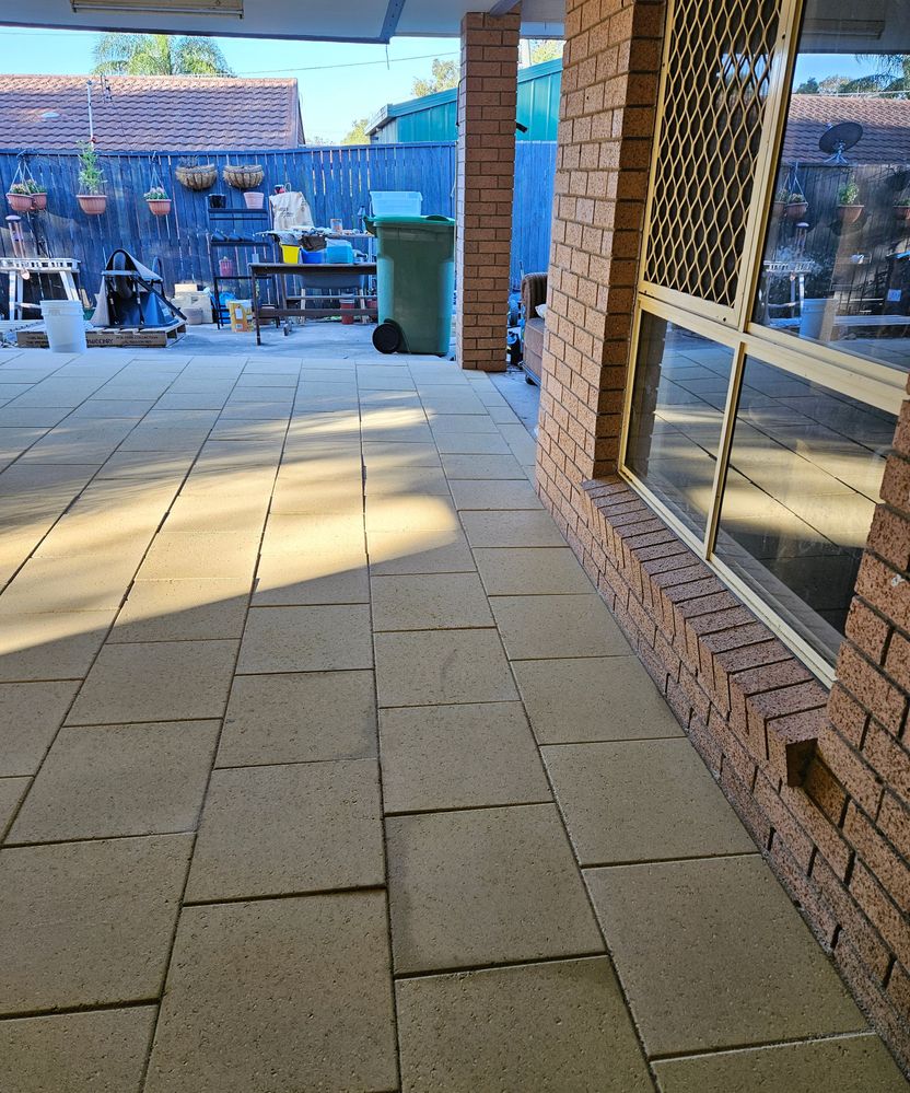

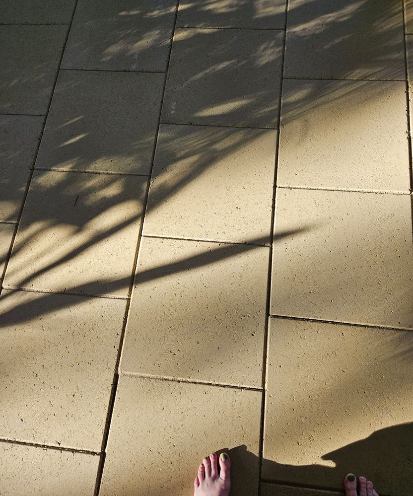

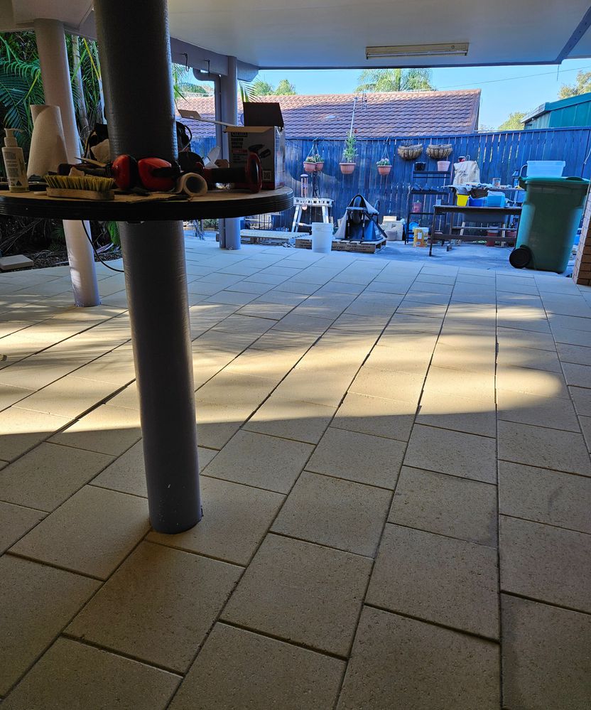

So the weather finally smiled upon me and I git my sand done at last
not sure if I was being too slow but it was actually a really hard jib and took me hours and it was sooooo hot
I was terrified of paver staining from the polymers but I think it turned out OK
Next step is sealant but again it needs to be dry but I want it sealed ASAP tmrw is supposed to be hot and dry also am hoping to get the sealing done but the sealant instructions are not at all encouraging- apparently it needs to be hot but not too hot and not humid
and apparently i need to mix it with solvent - why don't these things come ready to go 😒 🙄
Afternoon @lakiita
Looks great! Nicely locked together and I still cant get over your dads or your effort cutting the pavers to go around the post! ![]()
Scale of 1-10 how happy are you with it?
Id be pushing an 11!
