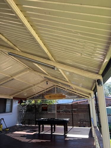

Hi Team,
i have an issue with my decking area, the metal ceiling drips with condensation on winter mornings.
It is a single metal sheeted roof panels with battons.
How can i resolve this issue permanently and be able to put nice things out.
what insulation would you recommend and also ways to install this?
thank you

Thanks Michell.
Yep I’ve looked at the links you provided and have taken down some ideas.
Option 1: Textured paint the whole underside including the beams. Dont know how affective that will be when finished.
Option 2: Take off the whole roof sheeting and then lay sarking. This is the product im thinking to use- Ametalin 1350mm x 22.25m ThermalBreak Roof and Wall Home Insulation. Once sarking has been covered i will then relay the sheets.
Option 3: Between the underside beams ill measure and cut foil board product ill use- Foilboard 10mm x 2400mm x 1200mm Standard 10 Insulation. Which ill attach the Purlin Brackets for adding the cladding later. I wouldn’t have to take the sheeting off for this right? I have attached a picture of my design thought.
My preferred choice would be option 3 if i don’t have to remove metal sheeting.
Also, i have noticed the condensation only drips from the beams, causing drip lines under the beams onto the floor in the morning. Don’t know if this is just the sheeting trickling down onto beams and then dripping off the beams onto the floor.
please let me know your thoughts on the options?
many thanks

Morning all.
I'm going to go with the Foilboard setup.
My plan is to fit them into the gaps between Purlins (space is 2400mm x 1005mm) and cut them to size.
I will secure them to the purlins with the Flexifast clips.
I will then tape up the exposed edges which should be hidden behind the purlins.
How much space should i leave behind the Foilboard and the metal sheeting?
What shall i do with the exposed roof purlins, as these will still be
metal?
Order so far:
24 panels of Foilboard Standard 10mm
Silver tape
Flexifast Clips.
Anything else required?
Many thanks
