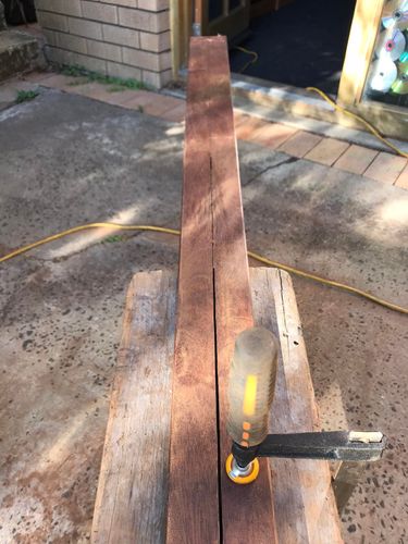

This is a 90mm ripped down to 45mm

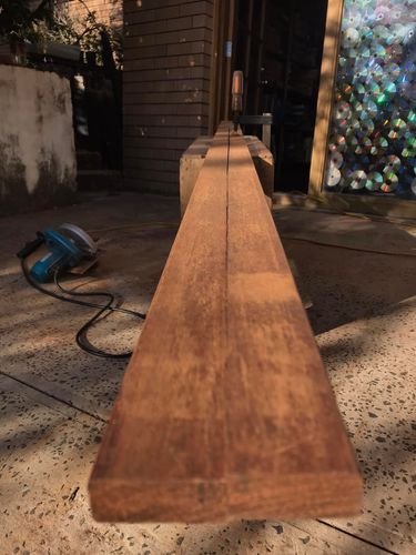

I needed something around the 40mm ish mark wide to help strengthen an armrail.

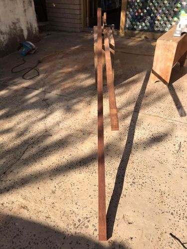

Scray but once I worke dit out it was easy, stressy but easy :smile:
If you cut 30mm It should fit between the grooves of the corrogated sheets. You could even make the timber slats taller then the black fence for a different look.
