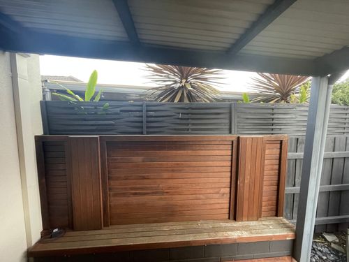

I am planning to prepare my outdoor area to be ready for an upcoming party and make it comfortable for guests to sit outside this season. The right side (when standing in front of my door facing front) is exposed to the North and usually faces wind gusts. The plan is to cover the sides, (and maybe the front 3 sections if needed) to stop the wind and place 1-2 heaters.

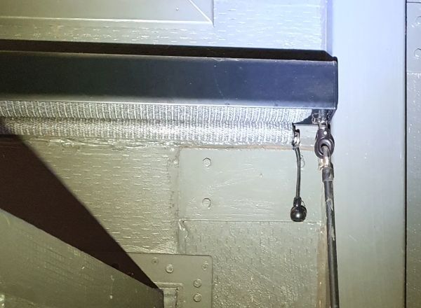

- The drop is 1950mm till the deck seat (pic 2)

5- How do I install the blind on left sides as the patio frame finishes before the deck wooden frame. If I mount where the frame ends, blind will drop on the seat. If I install it inside the patio, the blind will drop next to the seat i.e. till the deck.

- In this particular instance if you have the time to wait you can order a custom-cut bistro blind so that it ends at the seat. The bistro blind has a plastic extension piece that laps over the surface once fully extended.

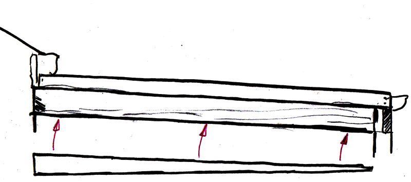

how about mounting the blind directly on the roof frame? I can tilt a bit to make it straight like this (notice the green line)
if thats possible it will save alot of time and effort

Just a thought > with a good straight edge and a reliable electric hand saw - cut a long beveled H4 section and glue/screw under the area you've indicated. This would give you a better chance of leveling and possibly look a little better?
Just a suggestion

I definitely believe it's possible to attach the blind to the roof frame of the alfresco. What's important is that the installation be made as level as possible. If you were to install it at a slight angle the bistro blind would come out distorted and out of shape. I suggest looking at the excellent suggestion made by @Noyade to achieve a level horizontal mounting point for the bistro blind.

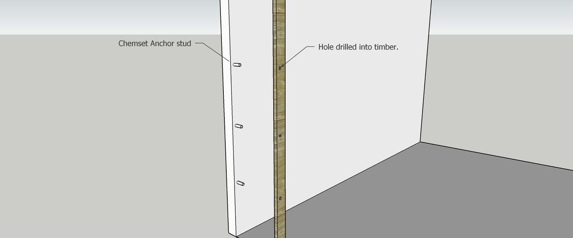

Using 70x30 is possible, to install it on your rendered wall, you'll need to drill some holes to install Chemset anchor studs in combination with the Ramset 300ml Chemset UltraFix Plus. You'll then need to drill holes in the timber piece and fix it in place using the nuts provided with the set.
I've placed a sample diagram below to give you an idea of how the Chemset Anchor bolts are attached to the wall. The timber piece is then positioned into place once the adhesive cures.
