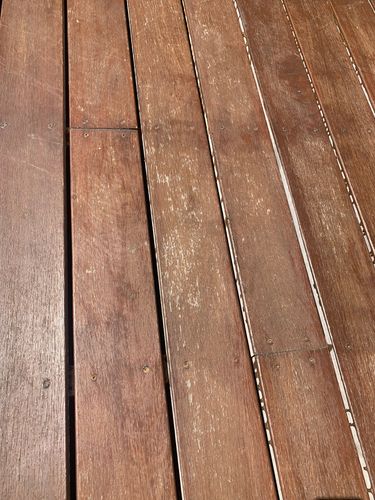

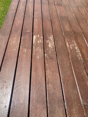

We’ve a large deck at home (plus also a front porch of the same material) that is 5 years old. It’s spotted gum and whilst we were good at maintaining it early on, I don’t think we’ve oiled it now for a year or so at least and it’s starting to show (see pics attached).
I would like to sand the whole thing back and re-coat it to freshen it up. My main query is what to re-coat/oil the deck in?

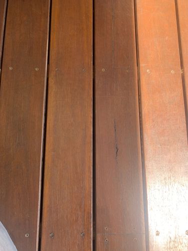

When we first had it done I absolutely loved the raw spotted gum and wanted it coated/oiled so we could see that but the tradie used an oil with a stain so whilst it looked lovely and new and shiny, you couldn’t tell the would was spotted gum and I thought it looked just like shiny brown wood, I had wanted something natural looking to protect it. The last photo shows an area of deck that is undercover and still in good condition but you can see the colour I’m talking about.

Before you sand the deck back, I'd recommend you try giving it a good scrub down with a stiff bristle scrubbing brush and Feast Watson Woodclean. You'll need to do two applications, but I think you'll be very surprised at how well it strips that colouring and rejuvenates the timber. Of course, if the timber is splintering or rough or the product doesn't strip the colour adequately, then it would be worth sanding. Sanding is a big job, though, so if you can avoid it, all the better.
For a natural look to your timber, you would go with a Natural oil that doesn't contain pigments. Pigmented oils are really only for a deck that's lost its colour, and you wish to restore it.
I recommend you pick up a deck oil applicator, and once you're done oiling the deck, pop it away in the shed with the remainder of the can. Try and give your deck a quick oiling once a year. Even on a large deck, it should only take 30mins to whip over the whole thing. Doing a quick yearly oil can save considerable effort in the long run.

All oils will change the colour of timber, but that doesn't necessarily mean they have a stain/colour in them. It's the same effect as wetting raw timber with water, it goes a much darker colour. The main thing to stay away from if you want to keep the natural timber colour is oil and stain combos similar to what has been used on your deck. These are heavily pigmented towards the timber colour they are trying to replicate. They are designed for decks of that species of timber where they have greyed and lost colour. The included pigments return the faded timber.
I can see that some of our Natural decking oils are lightly pigmented. I'd hazard a guess this could quite likely be due to needing a slight pigment for UV protection. The pigments included in a natural oil should be far less than a stain combo. I'd suggest you pick some up and try a test section.
