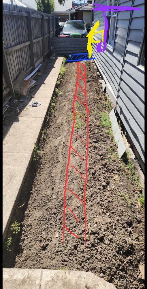

I have a drainage issue on the side of my house which is causing issues when it rains heavily as the water just pools and has no where to go. Unfortunately the only stormwater points are under a driveway and are unlikely to work due to the levels of the property in this part of the house.
Option 1: using geofabric, scoria and the megaflo to create a French drain to drain out into the backyard into a soak well  https://www.bunnings.com.au/reln-soakwell-rapid-flow_p4770021
After which I would put soil and grass on top.
Option 2: Same as above but instead of draining out to the backyard, connecting the megaflo to the bottom of a silt pit lifted up to the concrete level in the lowest corner then allowing the megaflo pipe to fill up and peculate out (hopefully evenly underground). Unsure if this will work but it will allow me an access point to pump water out in the event of very heavy rains.
Option 3: take much more soil out, sloping the ground away from the house backfilling with scoria, geofabric on top of the rocks then soil/grass on top. However don't think this would be ideal in case of very, very heavy rains.
Any thoughts / ideas?
Many thanks! 😀

Thanks. I actually bought a demo saw to remove the concrete that was next to the house. Removing it was a bit traumatic though! 😢
I think I've landed on my preferred option for feedback.
Red will be a megaflo green pip laid horizontally in a trench in the middle with sand feeding into the blue easydrain 3m cut to length which will feed into the yellow existing pipe under the driveway. Then will connect the pipe into a slit pit on the driveway (either cutting the concrete or putting the pit in the lawn). Purple is a gutter which needs to be reangled which will also feed into the slit pit then feed out onto the stormwater outlet on the road.
Will I need a plumber to connect some of this stuff even though it's being discharged onto the curb/road and not straight into the drains?

As to the question regaurding a plumber. I live in NSW and my plumber told me I could connect stormwater no issues HOWEVER other members from differant states have definently been told otherwise. I would suggest you hit up a local plumber to back you up on what you want to do for peace of mind. I do know Sydney water take a dull view on non standard things for sure.
Re: How to fix side of house drainage?
I'd agree with @Dave-1, @plentyofq. You should check with a plumber, council or waterboard in your area to determine whether professional assistance is required.
Otherwise, your plan sounds fine.
