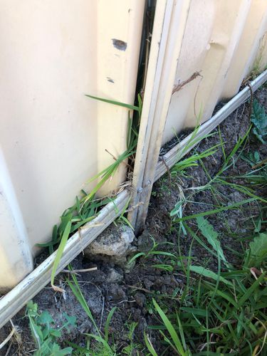

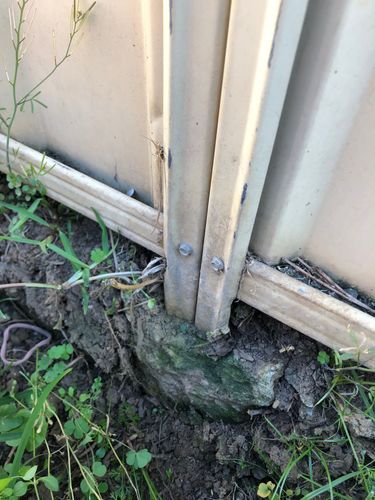

These are two photos of the footings. The second one is the one with the most lean.

Zooming in ou your first issue it looks like something has hit and kinked that fence. I would not be trying to push it back into place without removing that kink. Tho you may be able to after taking out that last section. Cross fingers. Colourbond fences are supposed to be resonably easy to dismantle and maybe all you will need after straightening the fence is a new top plate.

Agree with you in this Dave. To my eyes the post foundation looks to be the problem - especially with the last photo.
Using a crowbar break away loose concrete.
Dig a bigger base and prop the fence into the vertical position. You may need to jack the fence to be horizontal.
Concrete - preferably not that 'instant' mix type.

I agree with the above; the concrete footers have been insufficient for your soil type. I note the fence appears to have been constructed for the elevated soil height of the neighbouring property, and there seems to be a step down to the soil height on your property. Perhaps the fence footers were undermined at some stage? At this point, it sounds like increasing the size of the footers would be the best move going forward. If your property is lower than the neighbours, then you'd need to make the footer sufficiently large enough to support the post from your side.
