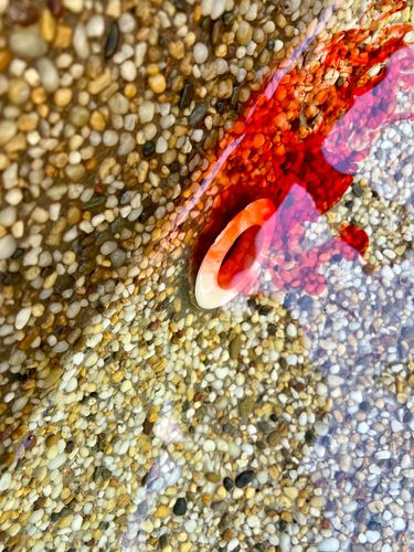

I did the colour test and think the return is where the leak is.
I have attached a pic just to be sure.
Mitchell, would you be able to advise me how to reduce the water level of the pool, so that I can repairs the leaks?

It certainly looks like that dye is being dragged into the outlet, @Sunda.

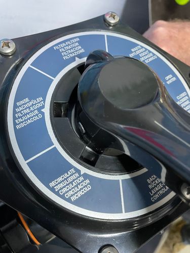

As mentioned, you'll need to take a picture of the filter for me so I can advise on where the switch might be. Look for a big selector dial with terms like backwash, filter, waste and recirculate on it. You just need to turn the handle on the filter to the waste setting and run the cleaner or have the cleaner hose in the water whilst running the pump.

I have taken pic of the filter similar to our sand filter for your reference, as the wordings on our filter have disappeared. It’s an old filter.
Would you be able to advise me how to lower water level?

The setting is called "Waste", as per the image below.
