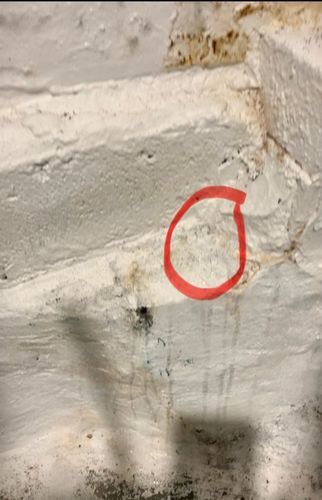

I would like to tackle fixing this ugly hole in the brick wall on the side of my house. Not sure why did the previous owner make it but it is quite convenient entrance for possums and other rodents so it has to be sealed.
The bricks are (roughly) 23x11x8cm, which seems to be a standard size.
I am guessing I will need to cut the existing broken bricks first and replace? I have an angle grinder, would that be a good tool for that?
What goes on the bottom? Can I just put a layer of mortar on the bottom? What mortar would be suitable for a job like this? What size bag?
The other thing I am unsure about is the barrier that is supposed to stop rising damp. There are a bits of it left but it has deteriorated. How do I replace that? Thanks for your help!

First question, as the hole seems to be made for a reason. How far can you see under the house? If you remove the dirt and debrie can you see a foundation or other bricks?
Id be tempted to find a similar brick colour and replace the missing brick using something along the lines of using a mortar tube
The moisture barrier I would leave as is. You could use a cold chisel and hammer to chip a brick down also. I dont think id remove that broken brick if thats what you are asking? I would use the mortar of your choice and then smooth the surface (if you were good at cutting a brick lengthways you could make a cover plate for the broken brick? ) I know I wouldnt be too succesful tho lol

It's great that you've received excellent advice from @Dave-1. His recommendation is spot on. By removing the soil at the bottom, you should be able to see the original brick base. In this situation, I would recommend just patching the hole with a similar type of brick. I would leave the existing moisture barrier attached and I propose filling the broken top piece with mortar, so you won't have to further disturb the broken section.
I recommend using 10kg Dingo Mortar mix in conjunction with Craftright 150mm pointing trowel. My best tip is to paint the repairs in the same wall colour and it will give your wall a nice uniform look.

Thanks for the advise! Just wanted to report back that the hole is fixed now! It’s certainly not perfect but I’m quite happy with the result
I started with exposing the original brick base as suggested, then I got rid of the remains of the broken bricks with a chisel and put few new bricks. I had to break one to make it fit into the existing space. I also put a layer of new moisture barrier as the existing one was torn.
Biggest challenges - right consistency of mortar (put too much water into the last batch), breaking one brick evenly to right size and fitting mortar into tight spaces.
The only issue I only noticed this morning was that I put two bricks wrong way around so the little notches on one side are visible. I think they are meant to be hidden. Oh well I’ll blame it on working in the dark
