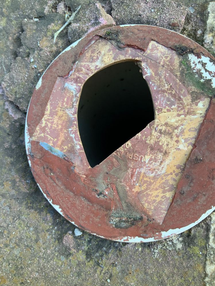

I had a plumber out yesterday who needed to do a jet blast of the pipes as I had issues with the toilet / gurgling / shower not draining.

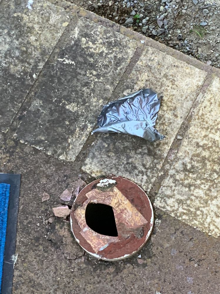

He was looking for a specific pipe outside my house to use which I didn’t have so he removed the toilet and went through there.

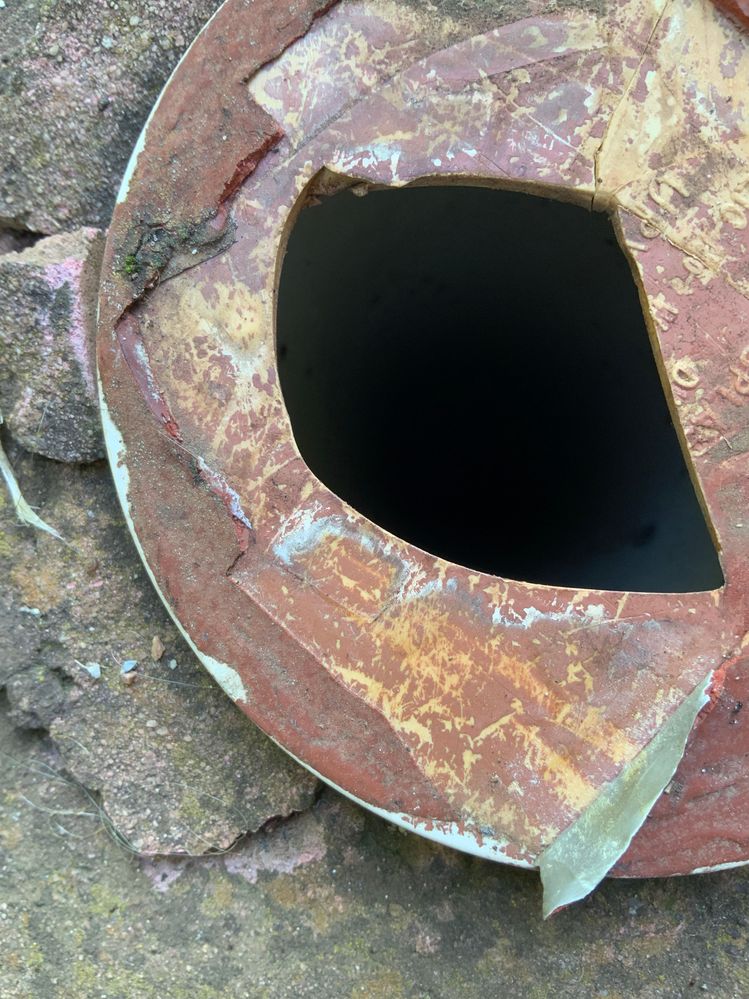

Unfortunately with a pipe outside, he ripped off the base / cover and now there’s a hole …
He tried to put tape over it but obviously it wouldn’t stick and now has suggested a 100ml PVC cap. Will this cause a trip hazard? What he removed was flat with the floor.
the cracked cement / rocks was also a result of him.
Amy other suggestions would be helpful.
Thank you.

I would suggest that you contact the plumber and request they come back and fix the pipe that they've damaged. Having worked in construction, the expectation set in place by my bosses, was that you return everything you've damaged in the process of a repair, to an equivalent or better condition than before.
There are options to cap the pipe such as Holman 100mm PVC DWV Push On Cap, but they will need some further concrete to be removed from around the outside of the pipe for it to sit flush with the concrete.
If you wanted to cap the pipe yourself, I am happy to assist further, but I would start by contacting the plumber and requesting they come back to fix the damage.

@JacobZ @Thank you for the reply. I appreciate your feedback.
I have reached out to him and asked he return but he assured me the cap will suffice.
I did see the push on cap you linked but upon researching it does require more work. Jackhammer concrete etc from my understanding.
I was hoping to cap it myself ? But I’m unable to cut the concrete etc and was looking for a simpler solution.
thank you again.

The only made for purpose solution I can see besides chipping away the concrete to install the push on cap, is to remove the rest of the existing cap, insert a 100mm Threaded Access Coupling and attach a 100mm Threaded Access Cap, but this would raise the pipe from the ground creating a trip hazard like you said earlier.

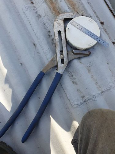

Afternoon @Newgreenthumb and Jacob. @JacobZ
Hard to tell from the photo - but is there enough room for the jaws of a super-sized pair of multi-grips to grip, twist and remove the cap?

I am afraid I agree with @JacobZ 's explanation. The plumber should return it to the same state or as close to possible to it. I would be contacting the company or the department of fair trading if they dont want to rectify it. So for the time being I wouldnt try any repairs on it as it would muddy the water.
What did the cover he ripped off look like? And would it be possible to cut a round piece of plastic and glue it to the surface (bevil the edgegs) to lesson the trip hazard?

I will be calling the plumber again tomorrow and I did go to my local Bunnings to get a cap.
Im not sure if it’s clear in this photo, but there’s no cap / lip to turn as Noyade suggested. Looking inside the pipe there is no edge to turn.
I have a door at over it at the moment incase it rains,
I can definitely glue a round piece of plastic as it looks like there was plastic before with some grey tape under?

when I try put my hand in and feel along the pipe, there is no edge it’s just all flat. Not sure that makes sense.
but you’re saying take the top off and then this bottled tap screw, will slide in the pipe? Sorry di that’s a stupid question.
