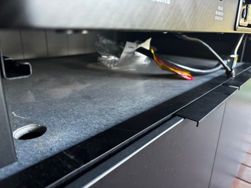

We purchased the latest Alfresco Plus Kitchen with a Matador Ignite 4-burner. The Alfresco BBQ module has the airframe.
When we placed the BBQ into the designated location, we noticed that the BBQ does not stand solid, it shifts sideways and the legs twist. It appears that the gaps between the BBQ and the airframe are too wide. There is an infill of some sort missing. In addition, there is no way to affix the BBQ to the BBQ module (the airframe). This all feels very unstable. This cannot be the final fix.
Secondly, there is a huge issue with the electrical cable and gas hose location being right at the front (!) clashing with the fat tray. There is no way to direct the cable and the hose to either side (as there are no holes in the frame) neither side or down as there is the fat tray. How is that good to be installed???? See attached pictures.

You can purchase the extension cable from Bunnings as its just a low voltage setup similar to the garden lighting.
https://www.bunnings.com.au/elluminate-extension-cable-2m_p4380419
When you put it in you need to look up underneath where the display panel is, there is a metal cover that you can feed it through and run to the other side. This keeps it out of the fat tray. Then I zip tied it to the gas line and ran it through the hole in my bench.

Hi Mitchel,
thanks for the explanation and graphics.
In my view, and I tried to force the hose around the corner, that's not an acceptable solution. In addition, the BBQ body is still swaying, even after I made the recommended adjustments, and finally, the screws which are use to fix the subframe (great tray and legs) is not of good quality.
