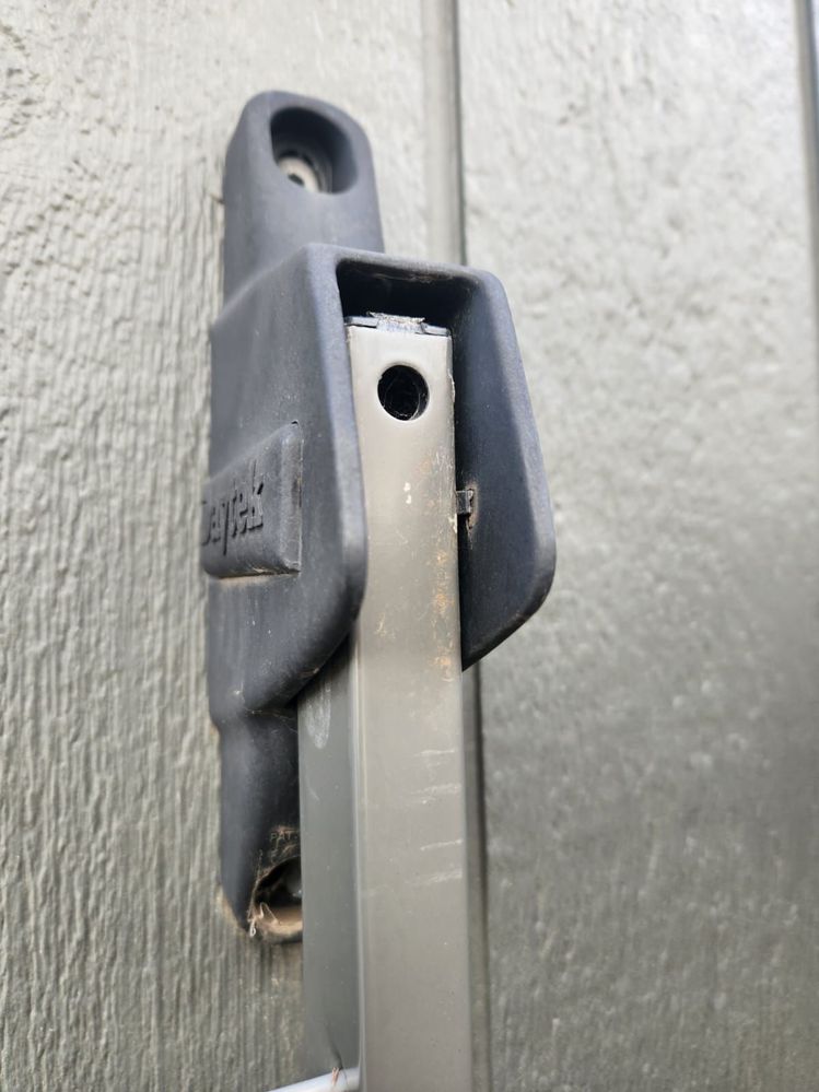

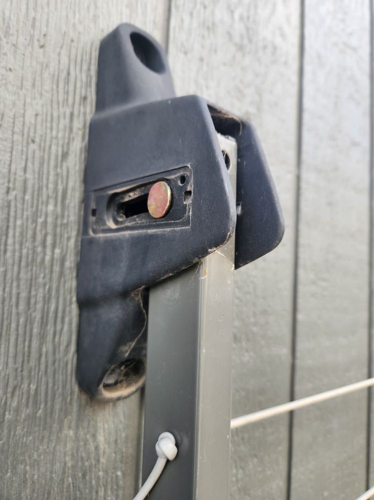

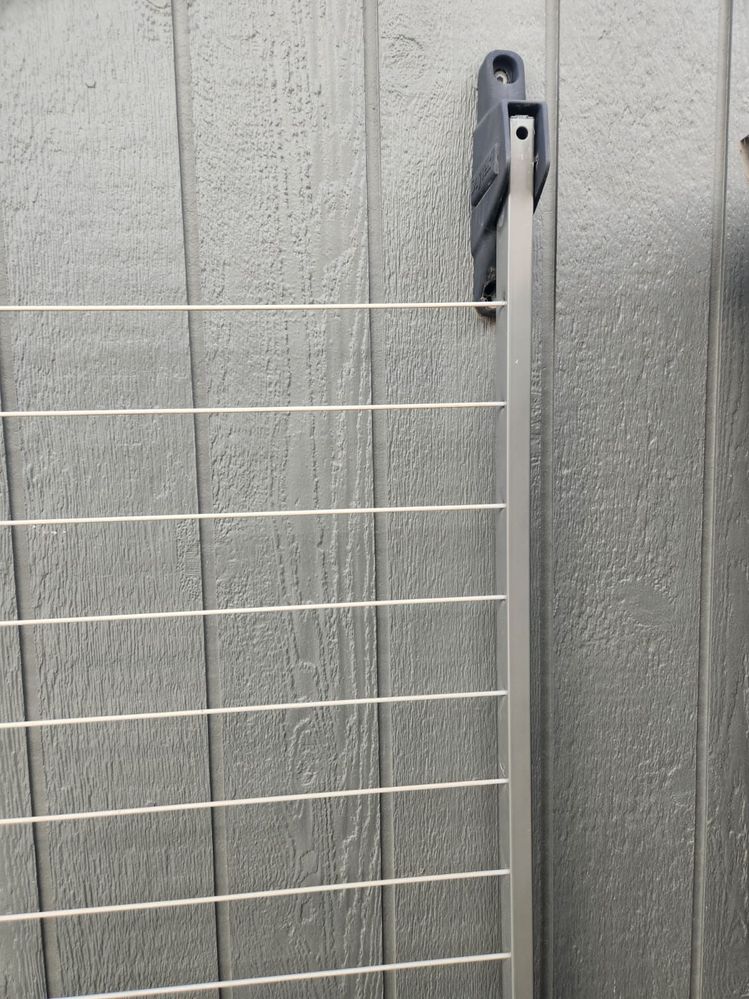

I would like to know how the attached cloth line can be on hold on straight, so that I can use it. Thank you.

This clothesline uses a Lift & Lock mechanism. To raise the clothesline, hold the FRONT BAR with hands spaced evenly. Lift above the horizontal line of the clothesline and push towards the wall. Release your grip and the clothesline will be locked into place. To fold the clothesline, lift the front bar with hands spaced evenly above the horizontal line of the clothesline and pull towards you. Slowly lower the clothesline and release your grip.
