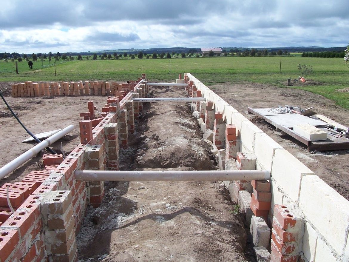

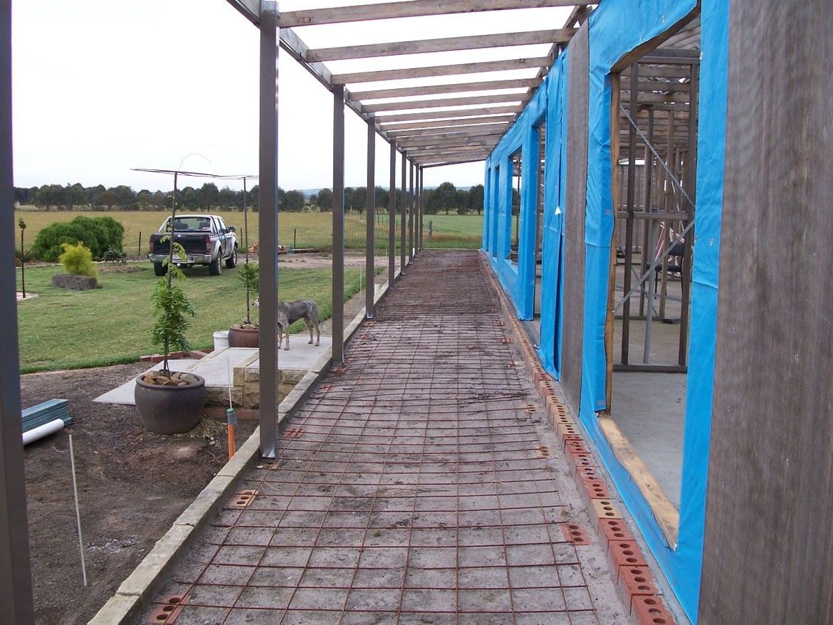

Having seen the pitfalls of decking here and there we chose to change out plans midway through the build and did concrete instead. Only had to fit venting every 5 mtrs so the airflow under the house wasn't comprimised being on stumps and the venting was just 90mm plastic pipe, then we filled the void with soil and finished with concrete. So happpy we went that way because ultimately it is zero maintenence too.
