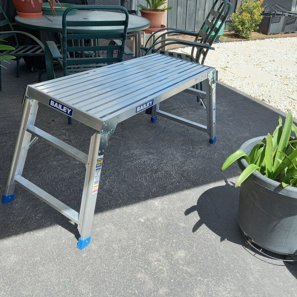

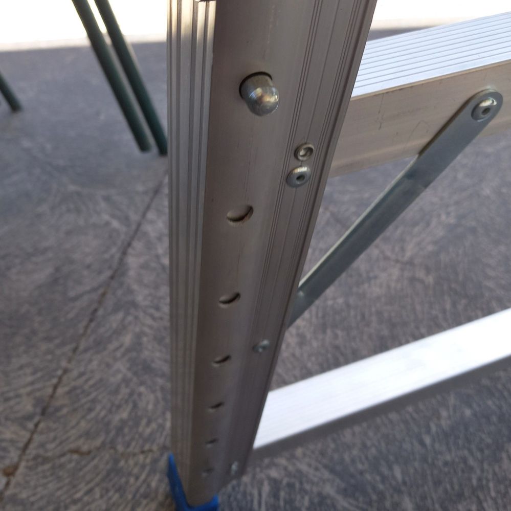

The photo of ladder and pin which I find it hard to push.

Yep, those are the type of pin I thought you meant.
I have this exact same work platform/trestle bench and agree that the pins can be a bit tricky to push in because they need to be strong enough to support the weight on the legs. With a weight rating of 150kg, they need to be pretty strong and under a fair bit of tension.
I have a technique that works for me and once you've got it, it is not too hard.
The way I do it is, I put my foot on the rung between the legs and use both hands to squeeze one pin in and pull the outer part of the leg up while pushing down on the rung with my foot.
There is enough movement that if you keep pressure on the rung with your foot the first pin will stay pressed in so you can then use both hands to push the other pin in. Make sure you maintain constant downward pressure on the rung between the legs or the first pin may slip back into place, and you'll have to start again.
You can repeat this for each level of height adjustment.
Once you get the technique down, it isn't too difficult, but as I mentioned above, gloves will also help as the pressure you need to apply can be hard on the thumbs. The clamps I mentioned will also work.

Thank you Jacob.  A tap with the mallet got the job done.  All legs extended.
Thank you so much.  All  I needed was a hint.  The mallet.
