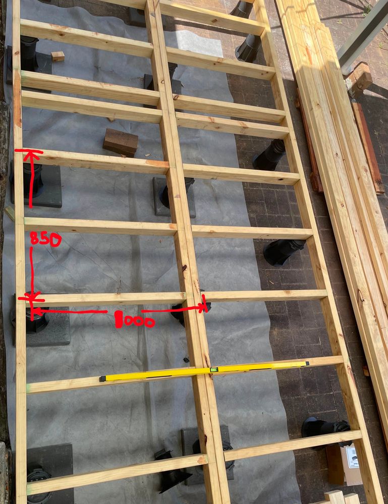

Please see below my current build so far, 2 frames (6000mm x ~1000mm each frame) attached together (still got another 2 frames to build, the pedestals on the on far right are currently there only to support the second frame, as soon as my third frame is attached to the second, i will fix them properly ).

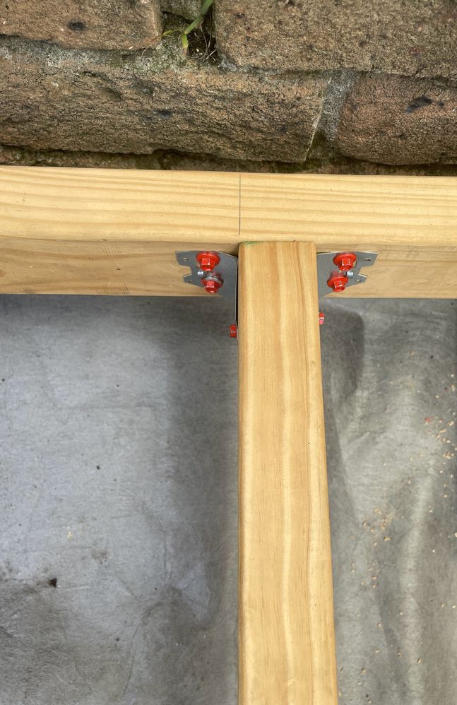

All my timber are 90x45 , as you can see the i have placed each pedestals at approximately 850mm (assuming bearer span allowed is 900mm and joist span 1200mm), I am using 90x45 joist hangers for those that doesn't have pedestals.
Does this sound right?

Hi @coolnav,
Basically, a bearer is a bearer if it sits on a post or pedestal.
Joists are attached to and supported by the bearers with no vertical support from posts or pedestals. The main characteristic that makes it a joist is being supported by a bearer. Whether it is sitting on top of the bearer or being attached to it with a joist hanger, it is still supported by the bearer.
Your bearers span 850mm between pedestals, which is inside the recommended 900mm span. Your joists span 1000mm between bearers, which is inside the recommended 1400mm span.
To put it simply, your deck frame is perfectly fine and will create a nice strong deck.
Thanks, @JacobZ! You explained it so clearly that even a beginner like me could understand. This really boosts my confidence that I'm on the right track.
@JacobZ ,
Another quick question, if you see my design with the frames where I join them together it literarily becomes a 90x90 (90x45 90x45 screwed together), does it mean that the span can be greater than 900mm or it doesn't matter and it remains at 900mm?
Evening @coolnav
It kind of does but really I would stay the course you are on as it looks like a nice solid deck. I find changing things middle of the project always causes flow on effects. One way I tested out my deck as I built it was to lay some boards on top the stand (loosley) on it and see if it flexed
yeah I looked like a kid doing a stress test but it put my mind to rest.
Hi @coolnav
I second @Dave-1's recommendations and to stay with your current design. I don't recommend changing anything while in the middle of your build. As Dave-1 said unseen flow on effects will spread along your deck framing plan that could produce undesirable consequences. You are currently within the safe zone in regards to your footing, it would be best to stay within that zone so that you'll get a solid decking frame.
