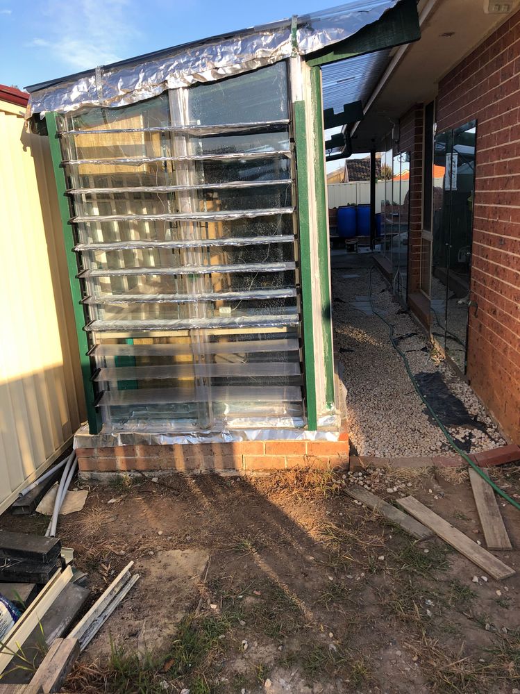

Yesterday added the external  Louvers made them out of Light weight but rigid and strong Polycarbonate roofing twin wall Sun tuff I/n 1010852
cut them up 4  louvers per sheet with small wastage (I love  that too, low wastage)

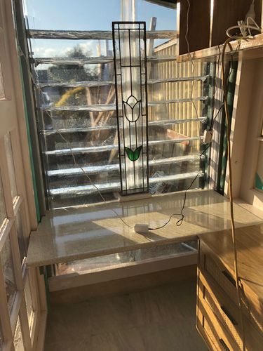

The panels with twin walls where 8mm thick the louver mechanism only 5mm slots  easy fix  squashed the 8 mm twin walls in vice at the tips and they slotted in nicely.  The afternoon sun was still blasting in so I add some aluminium foil as a test for reflecting the  heat away in the upper louvers  I am  waiting for next days   after noon sun to test it.  If This works I will cut up some aluminium flashing to louver size and glue it to the polycarbonate louvers externally.  After all life is a  box of chocolates now the outdoor room looks like a box of chocolates.  I told my wife I was  wrapping the outdoor room as a xmas present,  I got the look.  I also added a real  stained glass panel we picked up at a building  materials recycler.

Aluminium test foil for sun heat controlAluminium test foil for sun heat control
Inside view of foil test on louver and new stained glass feature addedInside view of foil test on louver and new stained glass feature added
