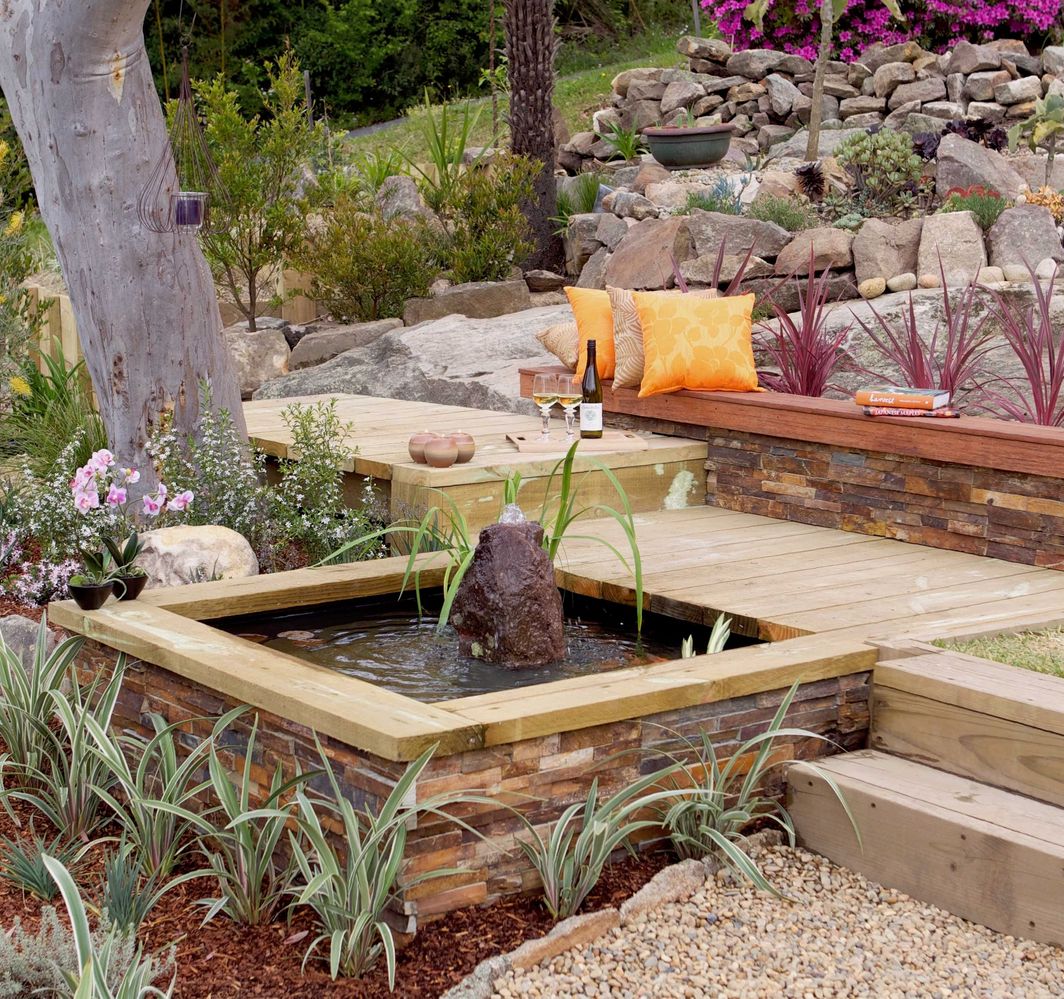

The photo I've included is a pond & board-walk I built where I created a stable substrate and then applied stackstone. I used two techniques with this project. One was blueboard the other was horizontal sleepers (hard to explain without showing all the images but had to do with the pond structure.)

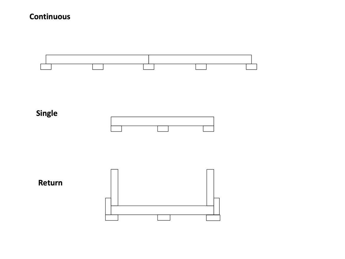

To prevent bowing over time, even in non-load bearing walls, 3 evenly spaces posts are always used. If your beam is 2.4 then the centre of post 1 would be at zero, post two at 1.2, post 3 at 2.4 if the wall is continuous.
This would obviously be modified to suit your situation. (see diagram I just quickly drew up, note there's no scale to this)
In your case you'd then want blocking too as I'd say that 1.2 is too great a span for blueboard.

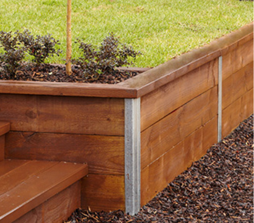

Hi @Adam_W ,
This is fantastic work and the video helped a lot in understanding things. I was just wondering if you have another video for the above pic, to demonstrate how you installed stone veneer on the sleeper surface? I have a sleeper retaining wall but not sure if I can cover it up with stone veneer. if not what's can you suggest as an alternative to it?
Basicalling my aim is to cover the gap between the 2 sleepers.
If stone isn't possible I bending towards using the plastic ones, but I'm not too keen as it's 'plastic'.
Cheers,
Re: Covering a retaining wall
Hi @sumitpramanik my pleasure & glad it was helpful.
The best way is to add a more stable substrate - surface below the final finish.

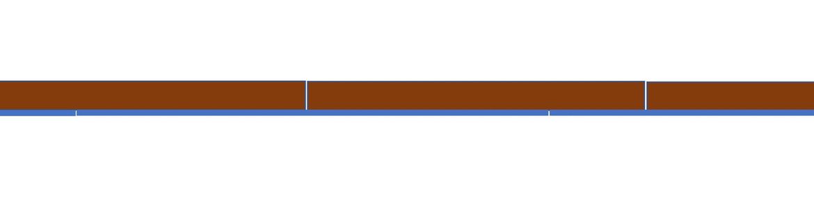

What I'd do with that wall is to cover it with blueboard, or another suitable exterior type board, it can be screwed & glued on. Then apply the veneer over that with a suitable adhesive.
You'd probably want to remove & replace the capping/coping on the wall as it will need to be a bit wider.
When you put the board on you also want to bridge over the existing joins to add strength & reduce movement. (see very rough diagram below)
