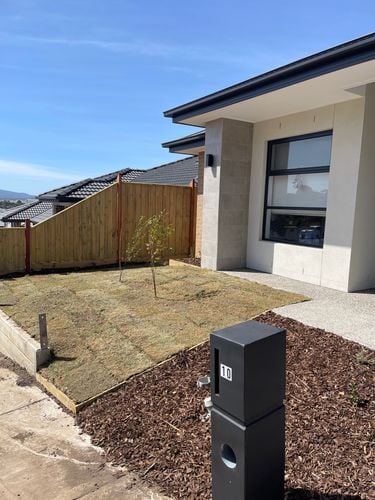

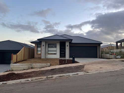

The above photos show the front landscaping for our new home, and I’d like to make some improvements to the concrete retaining wall.
I am thinking of extending the retaining wall to meet the garden bed, eliminating that annoying little patch of lawn between the bed and the retaining wall (it’s really annoying to mow!).
Thinking of adding an end post on the right and cutting down some concrete sleepers to slide in.
Secondly though, and this is the part I need some advice about -
I don’t like the look of the concrete retaining wall, and I’d like to look at covering it somehow.
I had considered covering it with blueboard and rendering over it, but I know a certain gap has to be left between the wall and the blueboard to prevent water damage. The main issue I have with this is that the gap between the retaining wall and the footpath is only around 4cm, so not much room for a timber frame and then blueboard on the top.

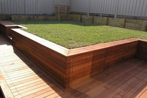

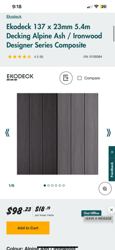

Another option I had thought of, was to perhaps use composite decking (like Ekodeck) vertically to achieve a similar look to my inspo photo above. I’d also want to cover the top of the retaining wall as well as the front. Has anyone ever done this before, and what does everyone thing about how this might look?

In regards to covering the retaining wall with composite decking, I suggest building a timber frame using 42 x 18mm 5.4m Moulding H3 Treated Pine FJ Primed 4 Edge Pencil Round LOSP. This frame can then be glued and anchored onto the concrete surface of the retaining wall. Composite decking such as Ekodeck can then be mounted onto the timber frame.
Having a timber frame means that you won't have to drill so many holes into the concrete surface. It will be easier to mount the composite decking and create the look you're aiming for. The timber frame is only 18mm thick and the Ekodeck is 19mm, when joined together they will give you a total of 37mm. Which means that it will be just under the 40mm limit and will technically not reach the footpath.

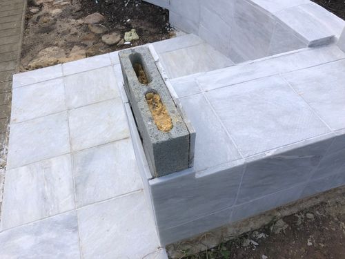

I used marble tiles to cover a cement besser block wall but there are many other varients you can glue onto the wall directly with tile glue. I would dig out that grass strip put in 50mm concrete and tile over that to as if it was part of the wall/
Eco deck costs a bomb I would rather use wood simulated ceramic tiles that are so real looking these days as it will last your life time.
I enclose my marble clade wall to help you think about options. Notice I also covered some ground area with cement and tile behind letter box.
Besser blocks capped with marble tiiles
