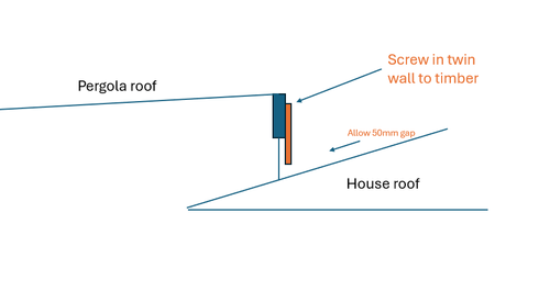

Thank you @Dave-1 @EricL @TedBear for the advice.  I assume it will be sufficient/strong enough to only fix the sheet to the rear of the timber pergola at the top?
Illustration below.  If so that would be a relatively easy fix!
Re: How to close the gap between pergola and roof?
Yes, you could fix it directly to the back of the beam @jonced3.
