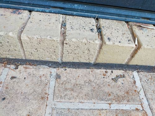

Hi All, I'm trying to repair and close some gaps between myhouse so that rat/mice or snake can't go into it..anyone know what is the black colour seal between the brick floor and the house bricks are (see below)
Anyone know what is the black colour seal between my outdoor floor brick and the house brick?

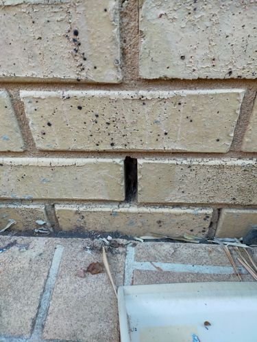

Also noticed myoutdoor house Brickd has gap see photo above. How do I seal it?

Hello @calccom21
Thank you for sharing your question about your outdoor brick gap. That brick gap is also known as a weep hole, they allow wind to circulate inside the wall cavity. The moving air removes evaporated water from the cavity to the outside preventing moisture damage. The foam item you are looking at is called an expansion joint filler. However, I suggest using a weep-hole vent cover to prevent vermin from entering your wall cavity. It's important to keep your weep hole open to prevent moisture from getting trapped inside your wall.
Re: outdoor brick gap
Thanks @EricL . By the way, what is the purpose of expansion joint filler and if it necessary to replace? And do I remove the old one and put in the new one? Also how do I know which size it fit mine?
Hello @calccom21
The purpose of the expansion joint filler is to cover the gap between concrete and brickwork. You'll often see it in houses and sidewalks when two large slabs of concrete are joined together. It prevents water and debris from entering the gap. Should there be any movement between the brick or concrete assembly the foam filler adjusts to the movement.
If your joint filler is still in good condition there is no need to replace them. The only reason it would need replacing is if it has deteriorated or has totally disintegrated. To determine the size you need, I suggest cutting a bit of the filler and comparing its size to the ones available at the store. The size does not need to be big, your goal is to get one that will fit into the depth and width of the gap available.
Hi Eric. I would also like to know what tape I could use temporarily that would seal water out from going into weep holes in brickwork during flooding.
Hello @Maximus33
Welcome to the Bunnings Workshop community. It's sensational to have you join us, and thanks for sharing your question about your weep holes.
If you are temporarily blocking the weep holes, I suggest using Parfix 340g Expanding Foam Filler. The foam will expand to three times its size and will properly block off the weep hole. When the time comes to remove the foam, make sure to use a Craftright 5-in-1 Scraper and dig out the foam. It will not be a totally watertight seal, but it will be enough that water will not come gushing through the hole and into your wall.
Tape is not a viable option as it will come off once submerged in water.
