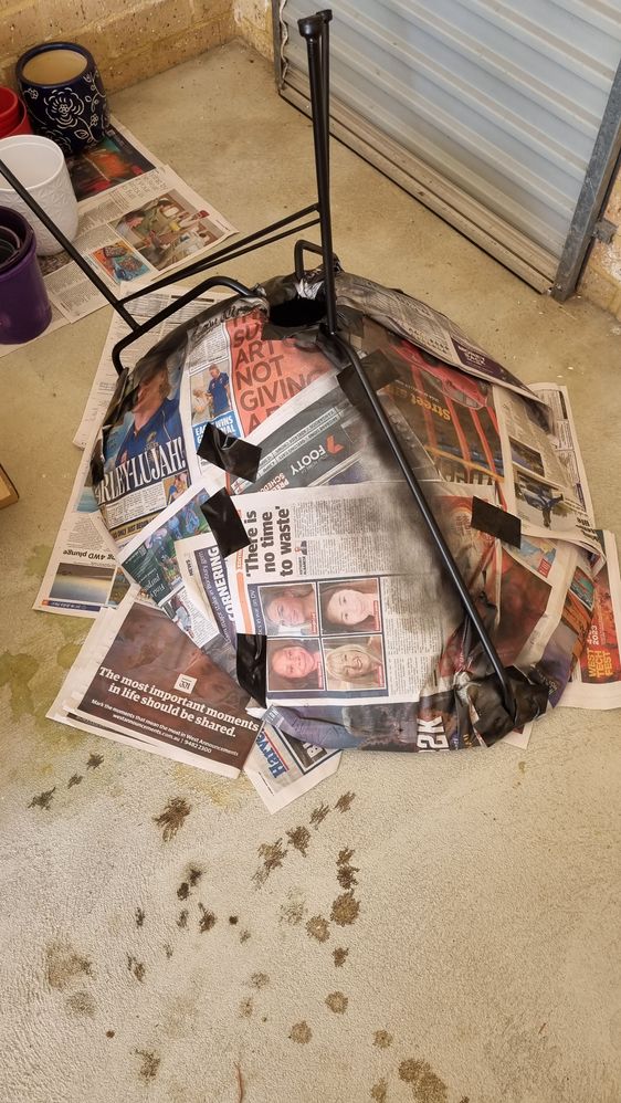

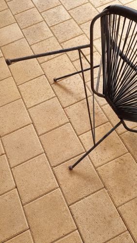

resprayed rusty chair legs
As a follow up for the question I asked about 3 weeks ago about rusty chair legs, I finished the 2 chairs yesterday.
They are just drying indoors as the spray paint in a couple of sections isn't quite dry.
Not sure I have the best newspaper wrapping technique, but project finished and am happy with the result.
Thank you again for the earlier suggestions.

Great work, @SusanJ! I'm so pleased that you've successfully painted your chair legs. You'll need to give us an updated image once they are dry.
Many thanks for sharing your results.
