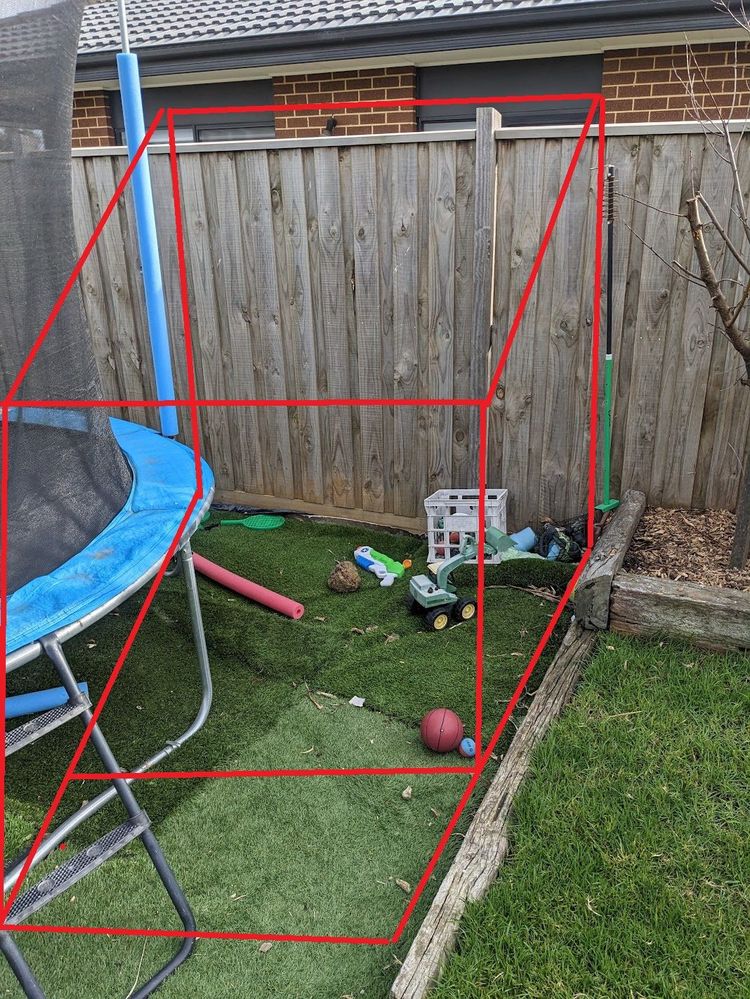

I am thinking of putting the cubby house here
You can see fake grass there. ( which is just basically a carpet I layed as a safer temp floor for the kids)
When we bought the house it was just all gravel. ( I think they may have stored a caravan or boat here)
so I was thinking of cutting a large square section of the fake grass out and dig up some of the gravel out and making deck that is level with the fake grass. Ill tuck some of the fake grass undernearth the deck to hold it in place to
What do you think? That should last ages right? Low Maintenace to right? I dont mind if I need to oil it or something but as long as its not all the time or regularly

If there is gravel underneath the fake grass I would leave it :smile: It means free draining hopefully and then I would place some blocks on top. Say 4 or six bessa style blocks then a few lengths of H3 timber to support the floor. That way it will last for ages. If you can find some of that concrete sheeting to place across it that would pollish it off.
There are also these Foundation blocks That would work nicely to give areflow or for the deck itself.
Re: How to change cubby house floor?
To clarify, Its just a thin layer of crush rock then dirt ( mostly clay ) underneath the fake grass
If I put it directly on top of the fake grass ( which is very uneven ) then blocks on top. It would raise the floor wouldnt it? I kind of wanted it to be level as much as possible with the fake grass around it. Just so they dont trip etc

What you're suggesting sounds like it would work @PatDIY_Dad and last for a significant amount of time.

Feel your pain. If its clay just under the gravel and you dig it out to make it level then those areas will want to retain water.
How about half way? Dig small footing holes and keep the timber off the ground so it wont rot and then an earthen longish ramp to the front of the cubby house?
Otherwise I would be thinking of scrapping the stones out and put in some sand/gravel and large pavers to keep it level with the ground. Id still be making sure I keep the edge of the cubby house away from direct contact alongthe length of the walls with some small blocks ect
