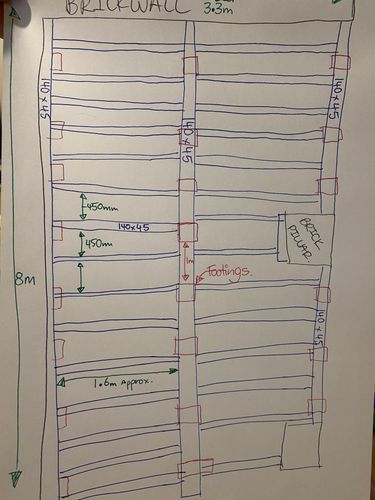

Now going back to a single level frame I’ve done a quick drawing using all 140x45 would this work?
3 main runs of 140x45 sitting on stumps every 1 meter then 140x45 running between all of them every 450mm.
hope the picture makes sense

Hi @Trentc
This is much better 140x45 plus the thickness of the decking panel which is 19mm gives you 159 which leaves you with 41mm as an air gap under the decking frame. I think it will be necessary to increase the number of footings to support all the short pieces of your decking frame. I also suggest bringing the footings closer to 1200mm for better support. Let me tag my teammate @MitchellMc in case he has a better idea on footings.
Re: How to build low-level deck frame?
Great thanks for the advice, i have footings 1m apart? keen to see @MitchellMc advice to add to yours thanks
