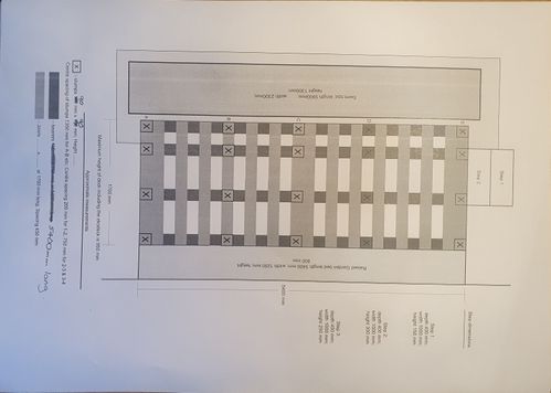

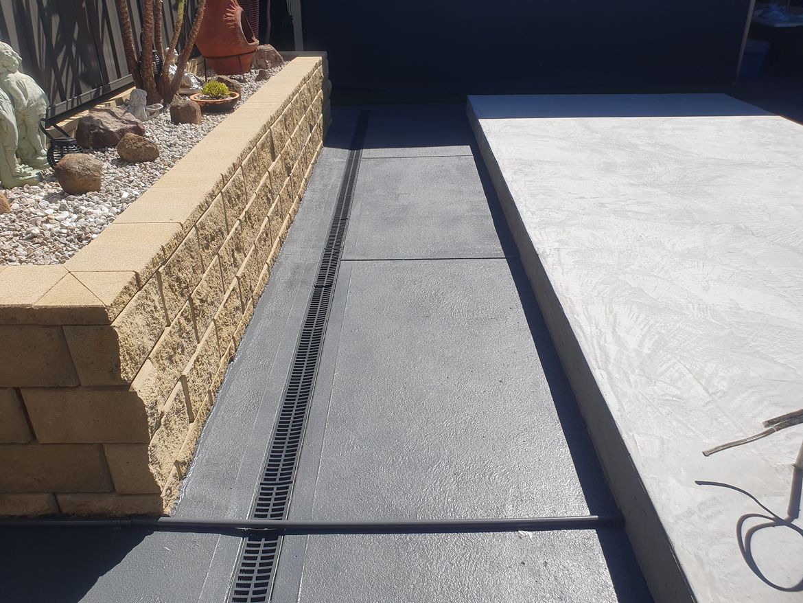

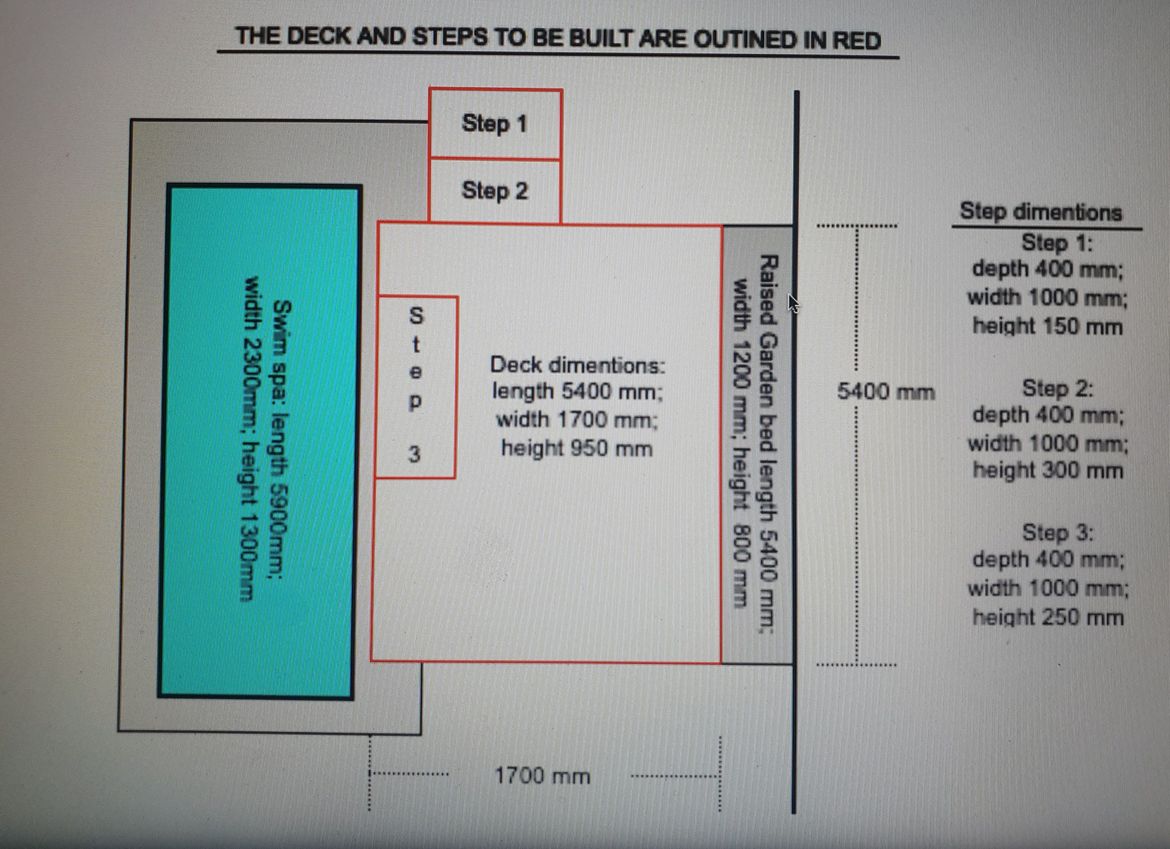

I am planning to build an outdoor decking on one side of a swim spa. The swim spar will be on the raised concrete slab, see photo. The deck will be between the swim spa and the raised garden, see photo. The decking will be on an uneven concrete base. The deck's dimensions are approximately. 950 mm heigh; 1700 mm wide; 5400 mm long with steps on one end and a step to go into the pool. See attached drawing in red.
I need some advice on how to build the deck substructure and what material to use.

The decking frame will be a rectangle at 1700mm x 5400mm, it gos past the raised concrete base, see the drawing.
The concrete base is 6400mm long and the pool will be 300mm in from the side to allow the deck to come up to the pool.

Hello @Rufo ( Andrew )
Thank you very much for the confirmation of the sizes and the drawing of the decking plan. Now that I see that the deck is right next to the swimming spa, this is something you'll definitely need to consult with an engineer or decking professional. I believe there are rules and regulations concerning the building of a deck when it's right next to a swimming spa. I suggest having a look at your local council's rules on deck construction next to pools.
