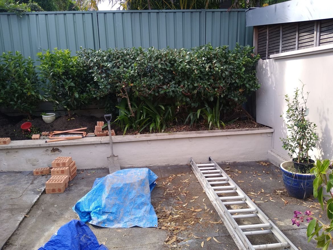

After further research and helpful input from you guys i am now planning to build an approximately 3m x 3m deck (no pergola) over a slightly sloping concrete slab in my backyard (pic attached).
I am a very basic diyer so want simple and easy to understand but want the deck structurally sound and long lasting.

Thanks Jacob, I'll definitely use the joist tape. Since the last post i purchased 9 of the modular decking kits and assembled them - pic attached. I had to cut one down to fit the available space but it shouldnt be a problem.
I have to say i am disappointed with the quality of the timber - see pics attached. Parts of timber missing, holes where knots have fallen out etc. Too much effort to return. Will the structural integrity be ok do you think? Anyway, thanks for all your information so far.
