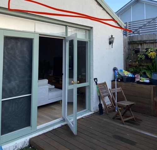

i  am aiming to build a pergola ready for this summer , it will be built out of f27 Blackbutt as that is what I have on hand
i have read a lot of mixed things about the feasibility of attaching a ledger board to a brick veneered wall, I’d love to get an idea if this is possible
ideally attaching the pergola to the home along the red line , then running rafters away from the home
thank you

Welcome to the Bunnings Workshop community @carrots72. It's wonderful to have you join us, and many thanks for your question about attaching a pergola to a wall.
As far as I'm aware, it states in the National Construction Code that brick veneer walls are not suitable mounting points for structures. However, I believe you can mount through them into the structural timbers behind. It would be best to engage the services of an engineer or builder to provide advice on suitable connection methods.
