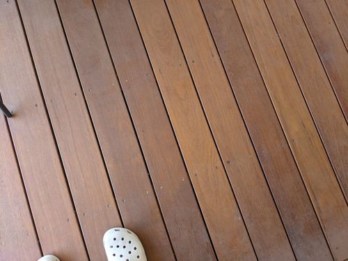

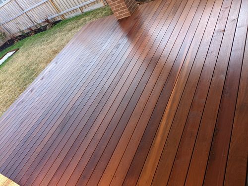

I couldn't wait, so I put the first coat down at 6:30p tonight. It took an hour, so I can get on with the 2nd coat at 8:30p. But the 2nd coat should maybe be a little quicker.
Even after the first coat, it looks SO good. The cleaning took some colour out of the boards, but the oil has brought that right back that gorgeous Merbau colour.

Beautiful
Re: How to build a low-level deck?
Hi @IronStan001
Thank you for sharing that update, I do believe that is the smoothest deck I've ever seen. It must be wonderful to walk on, my best advice is to put foam or rubber pads on the feet of the furniture you'll be placing on the deck.

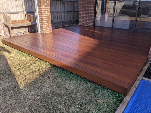

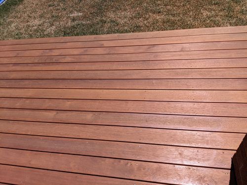

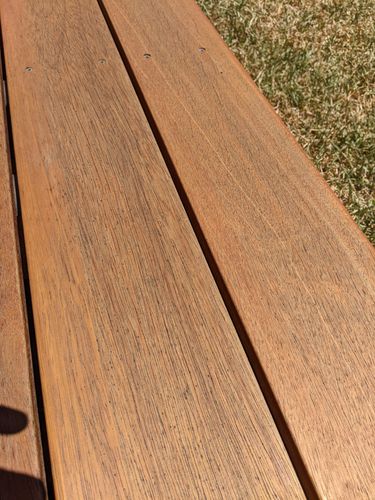

Last time I posted with regards to this project was post-oil using Integrain UltraDeck. Almost 12 months on, does it look like I need to re-oil?
The first 2 images are the section of deck that isn't undercover, whilst the 3rd image is always undercover. I've been noticing that the exposed boards don't seem have water beading on top as much as it used to, and if anything, they seem to be fading a little.

Hi @IronStan001,
12 months on, your deck is still looking good, but it sounds like a maintenance coat is in order.
Areas that have more exposure to the sun can sometimes require more frequent oiling, but 12 months seems about right for the majority of your deck. I'd suggest giving everything a fresh coat of oil now and assessing the sun-exposed areas in 6 months' time. If it is showing signs of wear in 6 months, you can apply another maintenance coat to those areas.
Give your deck a good clean with some Cabot's Deck Clean and an Oates Long Handle Deck Scrub Brush.
Once clean and dry, apply your maintenance coat of oil to the full deck.
